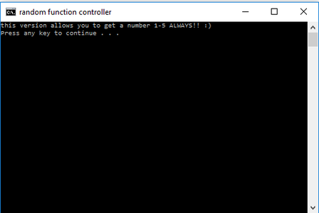

This is the Beta program and has slow speeds since the %random% variable can produce a large number and the loop, while quite fast, only takes 5 away each time. Copy the code between the **** To skip to the latest version of the code, go to the next step.
@echo off
title random function controller
:top
cls
echo this version allows you to get a number 1-5 ALWAYS!! :)
pause
set r=%random%
:loop
set /a r= %r% -5
if %r% LSS 6 goto num
goto loop
:num
echo the number is %r%
pause
:StartAgain
cls
echo again??
pause
set r=%random%
goto loop

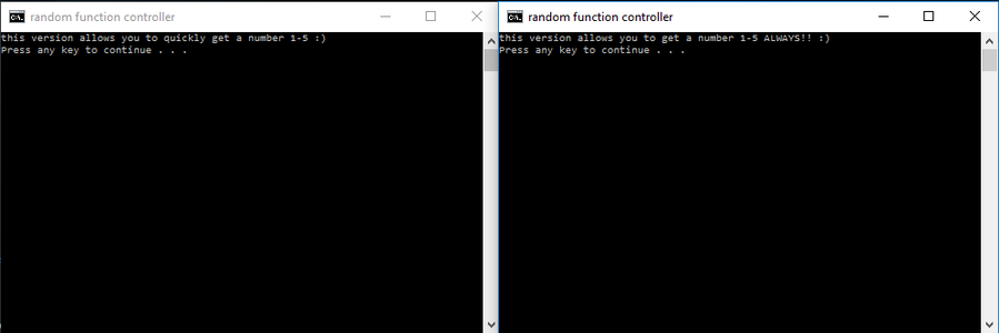

Step 2: Version 2.0
This is the faster improved version. Just copy and paste it into Notepad!
copy in between the ***********
@echo off
:top
cls
echo this version allows you to quickly get a number 1-5 :)
pause
set r=%random%
:loop
rem // the subtraction part is -995 instead of -1000 because %r%-5 comes after it. It would be possible to get a negative number.
rem // I have the code "if %r% LSS 6 goto num" twice in the loop because %random% spits out a number between 0-32767. If the number that %random% retrieves is 5 or less, you could end up with a negative number.
if %r% GTR 1000 set /a r=%r% -995
set /a r= %r% -5
goto loop
