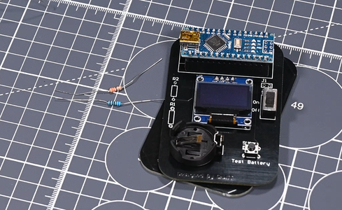

Step 1: Solder All Components to the Board EXCEPT the Two Resistors
Go ahead and solder all of the components to the board, following the schematic as necessary. Though, it's highly important to NOT solder the two resistors that form the voltage divider to the board yet! There is something that needs to be done to those resistors before they can be soldered to the board.
Step 2: Measure the Exact Value of the Resistors You Chose
Next, you need to measure the exact value of the resistors that you chose for this board with a multimeter. All resistors have a tolerance, which defines how far off of their advertised value they're allowed to be. The 1.5K and 3K ohm resistors that you picked out of your resistor stock are almost certainly not exactly 1500 ohms and 3000 ohms respectively. They're going to have some error, and that error will mess up the battery tester's voltage reading if we don't account for it. Grab a multimeter and measure the resistance of the two resistors you're going to be soldering to the board. Write these values down, and then solder the 1.5K resistor into R1's place and the 3K resistor into R2's place.

Now you're pretty much done! The only thing left to do is to upload the final version of your code to the Arduino - that is, the version of the code with your specific voltage divider conversion value and your specific screen's address punched in - and plug the Arduino into the board! If you choose to make the 3D printed 9V battery holder so that the 9V holds on to the back of the board securely and is still easily replaceable, go ahead and hot glue it onto the back of the board.
Now you're done! At this point, you should have a fully functional CMOS battery tester that you can use to test the CMOS batteries of all computers you work on. One final word of caution: don't leave a CMOS battery in the tester for a long period of time, as even though the load it places on the battery is very light, it can and will drain it over time, so just make sure to remove it once you've tested it. Cheers!
