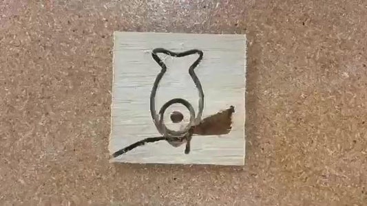

Step 7: Import ".svg" to Easel (by Inventables) for Engraving
The SVG (scalable vector graphics) format is used to define vector-based graphics while preserving their dimensional accuracy (magnitude) and direction (start - end position) properties. It is used to reproduce all types of two-dimensional designs in cutting and engraving technologies such as routers, lasers, plotters, etc. In the CNC language the vectors are translated to toolpaths (further on in the instructable we will talk about this subject).
To export from tinkercad the first thing to do is to make sure that all our geometries intersect with the work plane in a flat way (parallel to the surface) otherwise the vectors will not be drawn.
Then select the corresponding figure > enter the export menu > verify that the option "only selected figure" is enabled > and finally select the svg format.

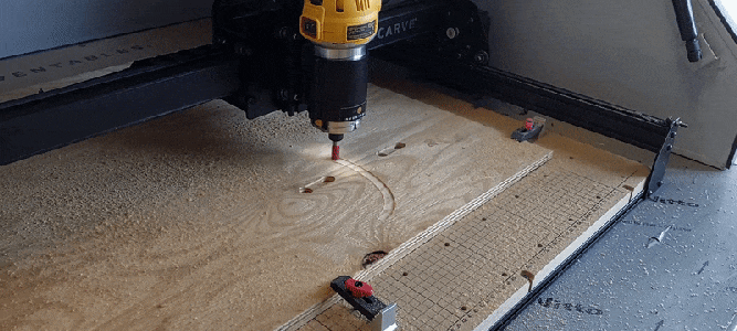

For CNC routing this project we used the free and online CAM software Easel by Inventables. This software is capable of producing g-code files to control both X-Carve (same brand as the software) and generic CNC router equipment.
To import your svg file into the program just access the project menu > and click on import SVG (another option is to use the Import button on the left toolbar).
Step 8: Select the Right Material
EASEL has made it very easy for us. We don't have to worry about the technical aspects of cutting because the software automatically calculates the speed at which the machine should move and the revolutions that the tool should spin, all based on our choice of material and dimensions.
The most important thing is to select the material closest to the one we are actually going to use and make sure to write down its exact dimensions (length, width and height) of our piece of wood; if we do not do this, we run the risk that the machine might fail and the drill bit break because it was not able to rotate fast enough to cut the material that we are using.
Step 9: Adjust Arrangement
Once our design (or vectors) is inside the work plane it is important to arrange it correctly.
The general rule of thumb is to leave a perimeter of at least 1 to 2 centimeters free that we will use to hold our piece of wood to the router's work surface.
Preferably we should orient the design right in the center of our material; however, this could cause to waste a lot of material. Another option is to align it towards a corner of the material always following the free perimeter rule.
This same rule applies for separating individual designs from each other that we are going to do in the same cutting job. All parts should be separated by at least 3x the diameter of the drill bit we are using (or simply by 1 cm to keep things simple).
Step 10: Set Type of Cut
A profile toolpath follows a line of an individual part. It's the digital equivalent of cutting a pattern by hand. Profile toolpaths (or profiles) cut around a closed shape to a specified depth. While there is only one type of profile cut, there are three different ways to make the cut:
- On cut: shows the tool cutting directly on the line. This type of toolpath works well for decorative details, but is not used for machining accurately sized parts.
- Outside profile: this is the most commonly used toolpath type becase it creates a true part outline. It only removes material outside the part line, maintaining dimensional accuracy.
- Inside profile: this type of toolpath cuts inside the part line. Because that, it is often used to make through cuts for features that occur inside a part, like a slot.
No matter wich side of the line you cut, this is the toolpath to use when you want to complety cut out a part (Rohrbacher et al., 2017).

Step 13: X-Carve It!
