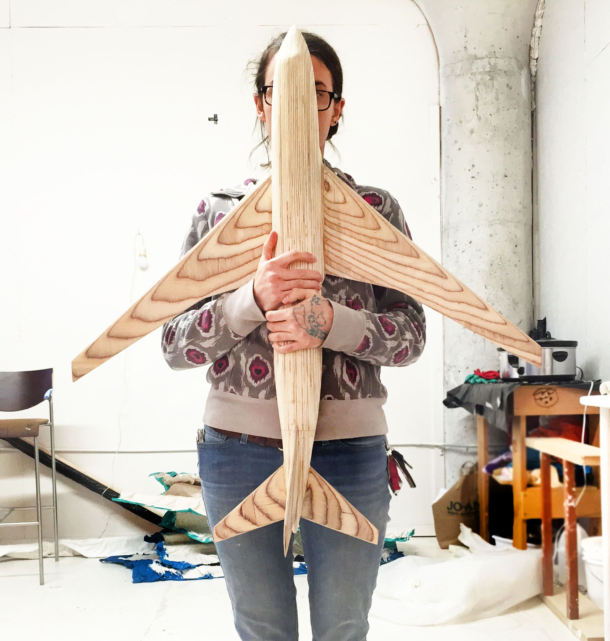

I've been using mold-making in my studio practice for the past six months and have loved it! I made a mold using a Boeing 747 replica that I had bought from a hobby store but I didn't like how small it was. My molds were too fragile. Then I realized that I can make a bigger model using a 3-axis CNC router. I thought it turned out so well that I would share the experience!

I wanted to experiment with solid wood (rather than plywood, although I did an Appleply version that was pretty neat!). I chose to try a lower priced softwood and went with blue pine--$3/board ft and still pretty! If you’re using plywood, cut the material closer to the size of your parts so you can easily flip and register your material. Also keep in mind that you can save your CNC machining time--as well as your bits’ lives--by preparing your material to be as close to the final thickness as possible.
-- I used 2 x [2" x 6" x 10'] boards of blue pine.
-- Glue up two sticks at 40" lengths one on top of the other for the fuselage.
-- For the large wings and the top back wing, glue up a 22" x 24" board (our drum sander has a 23" width parameter. If you have access to a drum sander or a planer that can handle wider, I would recommend adding 6" or so). I also recommend not adding too much to this second glue-up to keep flipping and registering 2" thick blanks manageable.
-- Make an 11" x 11" glue up for the two small back wings. Plane it down to 0.5" thick. Resawing this piece beforehand would be ideal.

Whew! You should be a pro at double-sided carving (if you weren't already). Lots of registering, flipping, tool path generating, and patience. Next is another way to test patience: finishing.
Step 6: Finishing
Now it's time to get this bad boy sanded, epoxied and finished!
For the rough edges I used 80 grit orbital sand paper. Per usual, I worked my way up to 240 grit--using a rasp to clean up the epoxy smudges. The big wings will look nice with the flat edges they have already but I preferred to bring them to the belt sander and set the angle of the plate to 7 degrees. I did this by cutting a scrap piece of wood and ripping a 7 degree angle down one side. Using my quick jig, I adjusted the resting plate to 7 degrees. Make sure the the angle is making the wing bend upward!
-- Fill in holes and tear out. I chose to fill in small holes with 5 minute epoxy because I didn't have any filler that would match blue pine. I also think that it just looks sharper. Sand this down to smooth.
-- Sand the wings and the fuselage to a nice finish, attach the wings one at a time using 5-minute epoxy. This may be crude, but I found just holding the wings in place firmly for the five minutes and then holding them in place with a wedge, they were stable and strong.
-- After attaching the wings, file and sand off any epoxy that dripped out and put 3-5 coats of a polyurethane finish, buffing in between layers with 400 grit sandpaper.
Hope you found this Instructable helpful and fun! You're cleared for take off!
