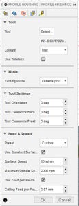

Step 3: Step 3: Roughing Tool Path Generation
In this section, I will be focusing on the first of two main operations for this project, roughing.
Roughing consists of linear passes removing a certain amount of material on the x-height, these are the passes that do the bulk of the material removal but leave a rough finish. The settings used in both of these operations will vary massively between cutting tool, insert, and machine, so it was a bit of trial and error for me until I was happy with both the cut depth (amount of material being removed) and feed speed (speed of feed in the Z direction).
For my 55-degree carbide insert, neutral hand profiling tool, and cutting 25mm mild steel, I settled at about:
0.1mm depth of cut
0.07mm per Revolution of feed speed
as well as a material surface speed of 60 meters per minute.
for this process, I made sure to leave 0.1mm of stock remaining for the finishing pass.
lead in 0.5mm prevents the cutter from ramming into the stock.
I've attached the tool file in the link below for anyone who would like to follow along with this demo!

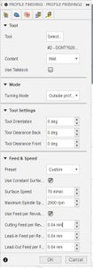

Step 4: Step 4: Finishing Tool Path Generation
The finishing pass is a more dynamic tracing path used as a final process to level out the surface of the material. this is usually at a higher surface speed, lower feed speed, and a greatly reduced depth of cut. for this step I used the following speeds:
2 passes
0.05mm depth of cut
0.05mm per revolution feed speed
70 meters per minute surface speed
The last step after this is to look at the machine simulation on Fusion360 and see if there are any noticeable errors in the path generation, these are red lines along the timeline and will show when the machine has a collision with the stock, fusion will also give you a warning in the operation menu.

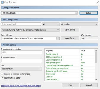

Step 5: Step 5: Post Processing
Post-processing is the process in which fusion converts the generated tool paths into machine-readable code, known as G-Code.
the required post-processor will be different for every machine, and possibly different depending on the operation. As we are using the lathe function, it's important that the Tormach "post-processor for turning".
I have included the link to this here. This needs to be saved to the posts folder on your computer, linked to fusion. Here is an article explaining this process.
My screenshot looks a little different as I have saved my post-processor to my Autodesk cloud folder.
The generated file should be saved as a .nc file and will contain the G-code. It is important to open this and read it to ensure it posted correctly. Once you're happy with this it can be saved to a USB.

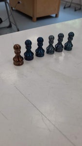

Step 8: Step 8: Finishing Touches
Hopefully, that last step went smoothly, and you now have your machined chess piece attached to the stock. As I don't have a parting tool so I do this step manually on another lathe, as well as polishing the chess piece.
Although my settings weren't perfect, it wasn't anything a bit of sandpaper and polish couldn't fix!
I added a final step of thoroughly cleaning the chess pieces in alcohol and testing some different tempering finishes, based on a chart I found online.
