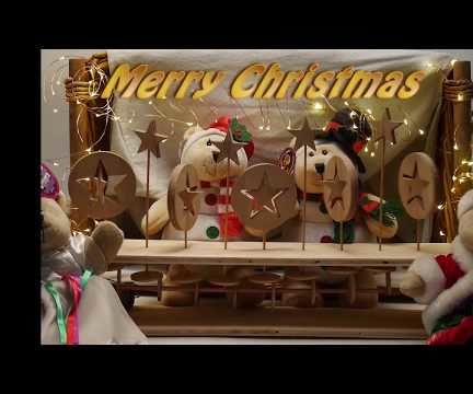

Update: New photo using the ornaments on bamboo sticks.
