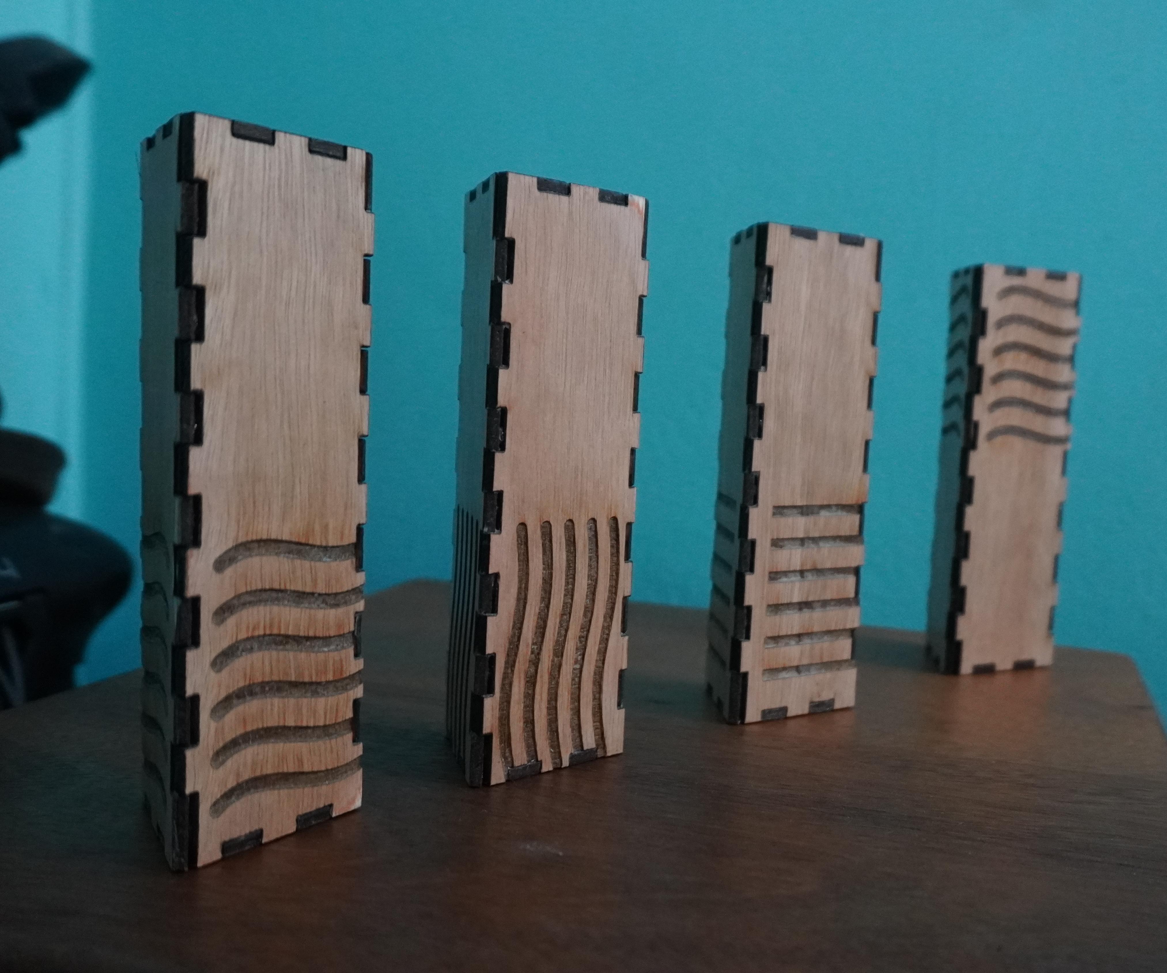

First take a bottom plate (the one with the little pins on the sides) and attach a side piece (the one with the round hole) to each pin.
Then slot in the three middle dividers (small square with 2 notches) to the bottom plate.
Next attach the top plate ( large rectangle with 5 slots no pins) to the three dividers.
To then start the next section slot the next bottom plate into the current side pieces then repeat this for the length of chain you require. you can attach the side piece on your first section at any time but once they are slotted in it is virtually impossible to add a bottom plate to them.
Only glue the vertical piece of wood to the bottom plate this will mean the top plate is removeable making it a lot easier to install the drag chain.
