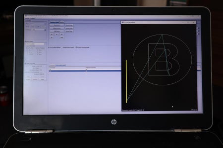

  • Photo 2 shows the traced image outline in the Processing3 graphics window
  • Photo 3 shows the Universal Gcode Sender Visualizer view

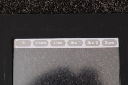

  • Download and print the attached file “menu.jpg” (photo 4)

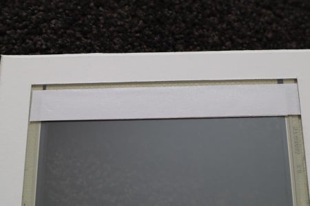

  • Tape the menu to the underside of the graphics tablet screen as shown in photos 2 and 3 above.
The estimated cost of construction is less than $25.
Images
  • Photo 1 shows the paper menu
  • Photo 2 shows the menu taped to the underside of the screen
  • Photo 3 shows the underside off the screen

Step 4: Operation
Before starting
Decide what g-code format you require

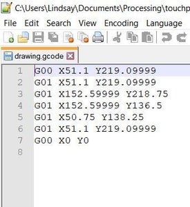

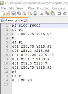

Setting the boolean GRBL flag in your header to “false” produces the code shown in photo 1
Setting the boolean GRBL flag in your header to “true” produces the code shown in photo 2. This code is suitable for use with the GRBL plotter described in:
Creating your “drawing.gcode” file
  • Touch the “*” menu button to start and follow the on-screen instructions
  • Touch any of the “mode” buttons to change modes while tracing an outline.
For example to draw a rectangle with rounded corners:
  • touch the “*” button
  • touch the “Line” button
  • touch the line start
  • touch the line end ... a continuous line will be drawn between the two points.
  • touch the “Arc1” button and follow the on-screen instructions
  • touch the “Line” button to draw the next line”
  • repeat this sequence for each corner
  • touch the “*” button to start a new outline
Touch the “Save” button once you have finished all outlines. This creates a file called “drawing.gcode” in your Processing “touchpad_receiver_v2” folder [1]
Plotting your “drawing.gcode” file
  • plug your plotter into a spare USB port
  • position the pen over the lower-left corner of the paper
  • launch “UGS” (Universal G-code Sender)
  • set the baud speed to 115200 and “connect” to your plotter
  • click “browse”.
  • find your “drawing.gcode” file, then click “open”
  • click “Visualize” to see the plot paths
  • click “Send”

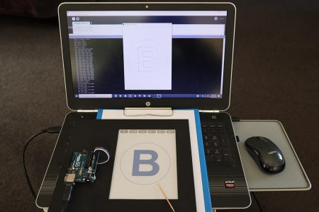

This Instructable describes how to make a CNC graphics Tablet from an Arduino and an 8 inch 4-wire resistive touchpad.
The gcode output from the tablet is intended for use with plotters ... not CNC mills.
The software supports GRBL plotters.
The touchpad has a resolution of 600 x800 pixels which translates to a 600mm x 800mm drawing if your target resolution is 1mm/pixel.
The project comprises an Arduino sender and a Processing receiver.
The Arduino is responsible for sending each touchpad coordinate to a PC which is running Processing3.
Processing3 displays what you have traced and generates a valid g-code file called "drawing.gcode" that is compatible with most CNC plotters.
