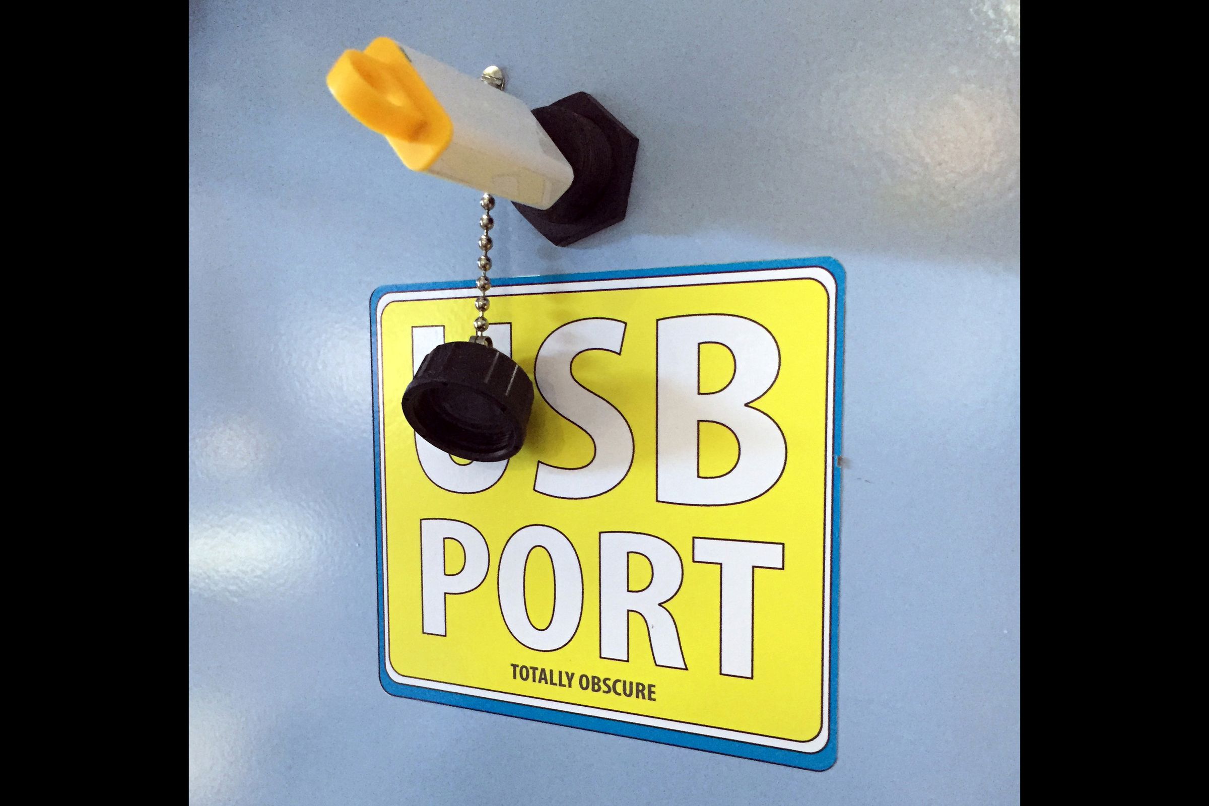

3) Load your programs (p. 14).
Double check that your files are named 100001.PIM and 100002.PIM. If your files aren't six digits, the DMS won't detect them.
