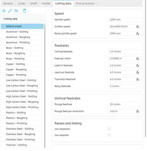

  5. Double click on the flat endmill and enter the desired feeds and speeds in the "Cutting Data" tab.

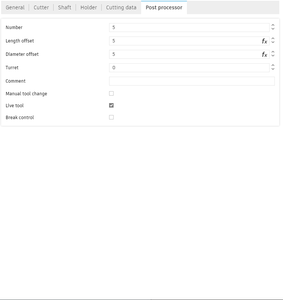

  6. If desired, change the tool number in the "Post Processor" tab.

  8. Repeat steps 5-7 for the ball endmill.
