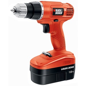

List of Tools
- CNC Milling Machine (I used a Shopbot)
- Sander/Files
- Mallet
- Cordless Drill Machine
- ¼ inch 2 Flute End Mill
In case you don't have a sander, just use a file or sandpaper.
You can use a 1/8 inch End Mill if you want higher finish.

- Using a cordless drill make holes at the mid point between two fingers through the edge of other panel.
- Using a screwdriver or drill put screws through the holes into the other panel.

I used a drill to make holes as directly putting screws or nails might split the MDF.
