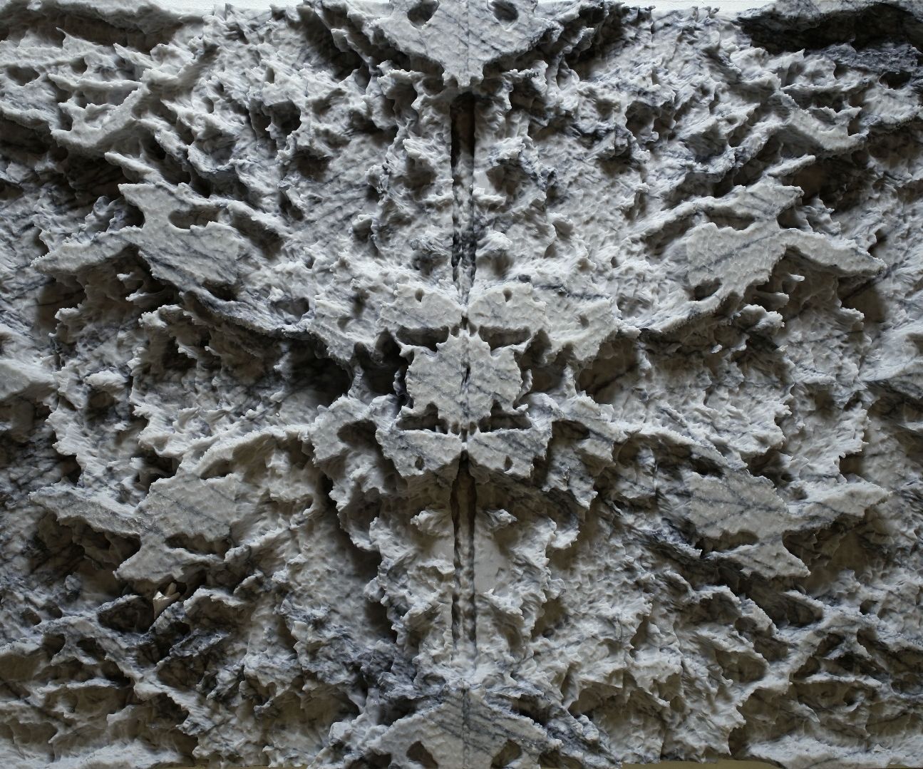

Continuing with the series I've been working on in aluminum, marble, and coal, I decided to create a panel in salt as well. This piece was directly machined on the ShopBot at Pier 9 during my residency there. Because there are already so many resources about ShopBot projects, for this Instructable I will focus primarily on acquiring, processing, and preparing the salt block, as well as the specific tooling and settings that I found were adequate for machining it. Here are a few goodresources if you need more information regarding CAM and toolpathing for a ShopBot CNC router.

Once I had the two halves of my block bookmatched, it was time to glue up what would be the final stock material. Before I could do so, however, it was necessary to clean up the edges of the two halves that would be in contact. There are many ways that you could do this (a tablesaw comes to mind), though I just ran a simple profiling pass on the ShopBot CNC router and produced two clean faces. For reference, these were the values I used:
Salt Profiling
- 1/2" Flat End Mill
- 10,500 RPM
- 0.250" Stepdown
- 0.125" Stepover
- Feed: 60 in./min.
The salt turns to powder almost immediately upon tool contact, so it's very hard to judge the cut by examining chips. You might have luck with other settings, but I found that these produced a very nice finished surface.
Edge gluing the two halves was similar to the acrylic lamination process I described earlier. Clamp your material up and wait for the epoxy to cure completely before proceeding to machining.
Step 4: Roughing
While unusual as a material for milling, the salt required nothing exotic with regard to setup or machining settings. I found the following settings to be effective, though I haven't experimented enough to say that they are optimal. I was very impressed at the degree of finish to the cut - the salt block felt glassy smooth where roughing had occurred. Feel free to base any of your own projects on these settings and let me know what you find in the comments. I'd love to hear of others' results.
Roughing Settings:
- 3/8" Flat End Mill
- 10,500 RPM
- Stepover: 0.100"
- Stepdown: 0.250"
- Feed Rate: 75 in./min.
Step 5: Finishing
As with the roughing pass, I don't know if the settings I ended up using are truly the 'best', but they produced results that satisfied me. In fact, while I had concerns that the salt would chip out excessively, this turned out not to be the case. Feel free to use as a starting point for your own experimentation. As I mentioned, I'm always interested to hear how things could be improved.
Finishing Settings:
- 1/8" Ball End Mill
- 10,500 RPM
- Stepover: 0.03125"
- Feed: 100 in./min.
