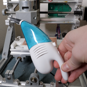

All this cutting and drilling can get messy. So I bought this small vacuum cleaner to suction up the dust.
