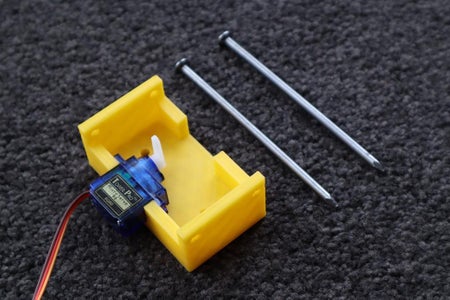

Step 2: The Servo Housing
The servo housing holds the servo and the two nails that are used for guides
The pen-up servo horn position is shown photos 4, 5, and 6

Step 1
- Shorten the nails such that they will just protrude from the base of the servo housing (photo 1)
- Remove any ridges with a file

Step 3
- Before inserting the nails into the servo-holder ensure that each side of the pen-holder slides freely under its own weight along a nail.
- This may require inserting a 4mm drill into the slider-holes to improve the fit.
- Don’t get carried away with the drill… any unwanted movement here will affect your plotter accuracy.
Step 4
- Insert one of the shortened nails through the servoholder, through the spring, through one side of the pen-holder, until it protrudes through the bottom of servo-holder (photo 3).
- The nail is a friction fit at each end of the servo-holder but the pen-holder should move smoothly.
