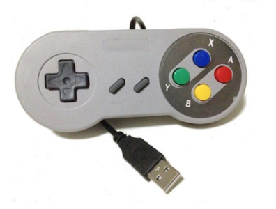

One part I used in this project was the left side controls of a NES gamepad (good old 'dogbone' controller). Now I could have shortcut the whole project by using just that and swapping the existing chip with the Pro Micro. This uses the same chip as the Leonardo, but much smaller package. The Leonardo/Micro is a HID capable chip, so it can pretend to be a mouse and/or keyboard. But I wanted an LCD display, so a custom enclosure and loads of complication is called for.

I had thought about using a rotary encoder, but I had been experimenting with a wireless PS2 controller and really liked the left side controls. Since I didn't really want to destroy the PS2 controller, I bought a new NES USB one off our local version of ebay (TradeMe) $5 + $6 for postage..job done! And what do we always do with new things?..take it apart.

- Fully disassemble the thing,
- Cut out a big enough circle for the face,
- Ensure you have enough of the circuitboard cut off to clean off some masking and expose the traces to solder wires to without impeding the action of the main knob.
You will find a main common trace that is connected to all 4 pads, then a trace for each. Solder a wire, should have 5 total. Don't worry too much about which wire goes where between the pad and the arduino, except for the ground..that needs to connect to the ground loop (obviously). If they are wrong, then you can simply change the pin assignment numbers in software.
I found that a couple of small drops of superglue on the mount tabs of the silicone pad helped keep everything aligned during reassembly. So your stack should be:
- Circuitboard
- Silicone button pad,
- Button,
- Faceplate
Hotglue to the rescue again to stick the layers together around the outside only. You do not want glue to get inside as it will inhibit the button action or prevent a pad from making contact. Glue and test..then retest.
