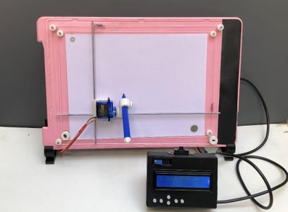

In this session of Instructables, I'd like to share a CNC Plotter Controller. This Controller can be used to operate CNC Plotter. It operates on batteries completely without a computer. I made this controller to operate my Mini Plotter V2. However this controller can be used to operate different CNC plotters without the PC/Laptop. It uses memory card that stores drawing programs. You can store a large number of gcode program files on it. Let’s make it!

Step 4: Assemble All the Parts
Mount LCD keypad Module on the Arduino Uno.
Make all necessary connections as per the Circuit diagram.
Put LCD Keypad Module along with Arduino Uno inside the 3D printed Body.
Mount Battery holder at the bottom of 3D printed with the help of Screws.
Drill a hole at the right lower corner of the 3D printed body to insert Data cable.
Insert the SD Card in the SD card module Slot.

Step 6: Working
Connect USB Cable of CNC Plotter Controller to the CNC Shield V4 USB port.
Switch ON the push button. The CNC Controller Starts.
The drawing program file is selected using the Up/Down buttons, The Extreme Left button used to run the Gcode and Extreme Right button is used to stop the Gcode.
Select any Gcode file and then click extreme Left button to run the Gcode.
It's Working now..
