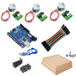

1- Arduino UNO:
- The brain of your CNC plotter, which will run the code and control the motors. You'll program this with G-code instructions.
2- 3x 28BYJ-48 Stepper Motors with ULN2003 Driver Boards:
- These motors will handle the movement of the X, Y, and Z axes. The ULN2003 driver boards allow you to control the stepper motors using the Arduino.
3- Jumper Wires:
- Essential for making connections between the Arduino, stepper motor drivers, and other components.
4- USB Cable:
- For connecting the Arduino to your computer, both for power and for uploading code.
5- Micro Switches (Limit Switches):
- These switches act as endstops to prevent the motors from moving beyond the boundaries of the plotter for x and y axis. They help the machine identify its "home" position.
6- 5mm Plywood and Screws:
- The base structure for your plotter. You’ll use these to create the frame and axis guides for the machine.

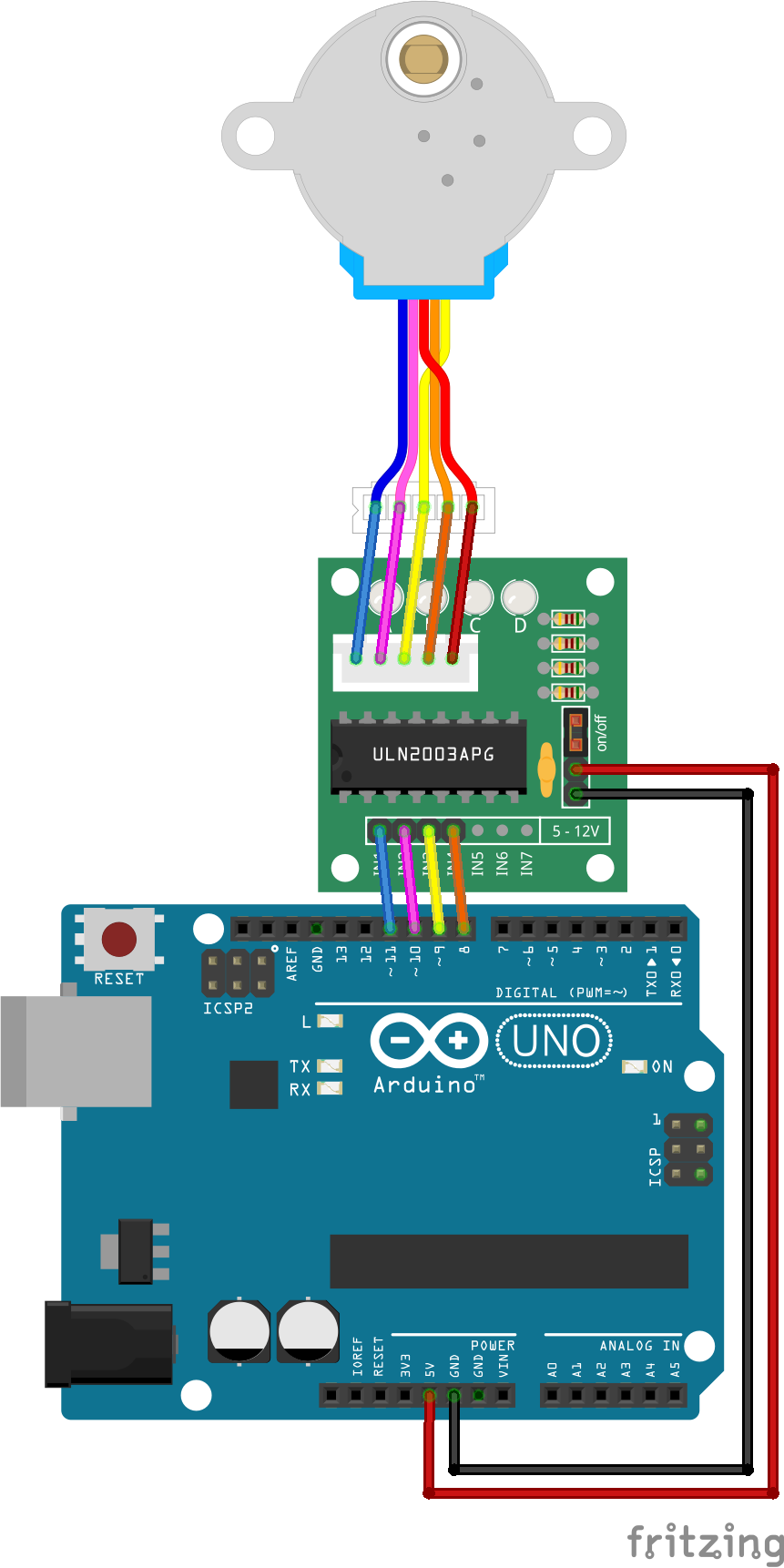

Step 2: Testing the Stepper Motor
Before moving forward with the full CNC plotter setup, it's important to test the stepper motor to ensure everything is functioning correctly. The diagram above shows the basic wiring needed to test one 28BYJ-48 stepper motor using an Arduino UNO and the ULN2003 driver board. Here's how you can set it up and test the motor:
Wiring:
- Connect the Stepper Motor to the Driver Board:
- The stepper motor has a 5-wire connector, which fits directly into the corresponding port on the ULN2003 driver board. Make sure it's securely attached.
- Connect the Driver Board to the Arduino:
- IN1 (on the driver board) → Arduino D8
- IN2 → Arduino D9
- IN3 → Arduino D10
- IN4 → Arduino D11
- Power the Circuit:
- The GND (ground) pin of the Arduino should be connected to the GND pin on the driver board.
- The VCC (5V) pin on the Arduino should be connected to the VCC pin on the driver board, providing power to the stepper motor.
- Power Supply:
- The stepper motor can also be powered directly through the driver board using a 5V power supply connected to the power terminals on the ULN2003. Make sure the ground of the power supply is also connected to the Arduino ground to avoid electrical issues.
The code to test the stepper motor is uploaded below—simply upload it to your Arduino to run the stepper motor :

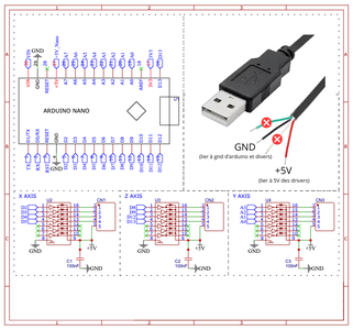

Step 3: Wiring the Circuit for Your CNC Plotter
In this step, we will establish the connections between the Arduino and the stepper motor drivers to control the movement of your CNC plotter. Each stepper motor requires a driver, and the connections are made as follows:
- X-Axis (Stepper Driver 1):
- Pin 1: Connected to Arduino D2
- Pin 2: Connected to Arduino D3
- Pin 3: Connected to Arduino D4
- Pin 4: Connected to Arduino D5
- Z-Axis (Stepper Driver 2):
- Pin 1: Connected to Arduino D9
- Pin 2: Connected to Arduino D10
- Pin 3: Connected to Arduino D12
- Pin 4: Connected to Arduino D13
- Y-Axis (Stepper Driver 3):
- Pin 1: Connected to Arduino A5
- Pin 2: Connected to Arduino A4
- Pin 3: Connected to Arduino A3
- Pin 4: Connected to Arduino A0
Each driver controls a specific motor, allowing precise movements across the X, Y, and Z axes. Additionally, it’s crucial to connect the power supply properly: the ground (GND) of the power supply should be connected to the Arduino ground (GND) to ensure a common reference point for the entire circuit. The power supply should also connect to the stepper motor drivers, providing them with the necessary voltage to operate. By maintaining this setup, your motors will receive consistent power, enabling smooth and accurate plotting.
This wiring arrangement forms the backbone of your CNC plotter, ensuring that each component works in harmony to execute your G-code instructions effectively.

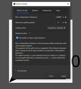

- Convert Path to G-code (.ngc)
- Navigate to Extensions > Gcodetools > Path to Gcode.
- In the dialog that appears, adjust the following parameters:
- Biarc interpolation tolerance: Set to 1.0 (or your desired value).
- Maximum splitting depth: Set to 4 (or your desired value).
- Cutting order: Select “Subpath by subpath” for processing each part of the drawing separately.
- Depth function: Set to 1 unless your plotter requires specific depth values.
- Ensure Sort paths to reduce rapid distance is checked.
- Click Apply to generate the G-code. Make sure the output format is set to .ngc.

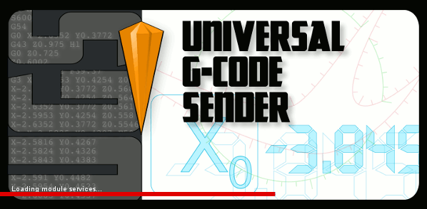

Step 5: Setting Up Universal Gcode Sender for CNC Plotter Control
1- Install Universal Gcode Sender Platform:
- Download and install the Universal Gcode Sender (UGS) software from its official website.
2- Upload GRBL to Arduino:
- Open the Arduino IDE.
- Install the GRBL library if you haven’t already.
- include the library in your arduino IDE
- Go to File > Examples > GRBL > GrblUpload and upload the example sketch to your Arduino.
Open UGS Platform:
- Once GRBL is uploaded to the Arduino, launch Universal Gcode Sender platform.
- Connect to your Arduino through UGS using the correct port and baud rate (typically 115200).
- Then follow the steps shown in the video (step6) to configure UGS for your CNC plotter.
Note : For more detailed instructions and visual guidance, be sure to check out the video tutorial in Step 6.
