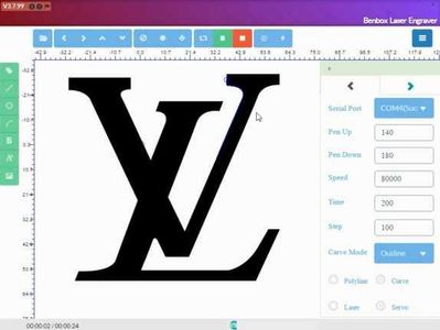

Step 4: Setup of Benbox Software
Now we have to setup the Benbox software. Download the Benbox software and install it in your computer. After this open the software and select the language you prefer. Then you have to choose the port and arduino type. Also you have to upload the firmware in the Benbox software. Now you have to change some settings in the Benbox software as per the requirement. Click on the three bars at the top right corner of the Benbox software and then follow the steps. Read More >>
