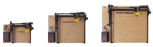

Inventables X-Carve
The Inventables X-Carve is a great choice for makers with limited space and a limited budget. It comes in 500 X 500 mm (19.5 X 19.5 in), 750 X 750 mm (29.5 X 29.5 in), and 1000 X 1000 mm (39 X 39 in) for $1,200, $1,350, and $1,460 respectively.
All models use a Dewalt router (which is easy replaceable) as the spindle and have a 65 mm (2.5 in) Z depth which is more than enough for flat pack projects and relief sculptures.
The company claims a .075mm - .13mm accuracy resolution, which is really impressive considering the price.
In short, if I were to own my own machine I would get the 1000 X 1000 version. You can do a lot with 39" of width, and you can cut longer sheets if you properly index and move the panels as demonstrated in this video.

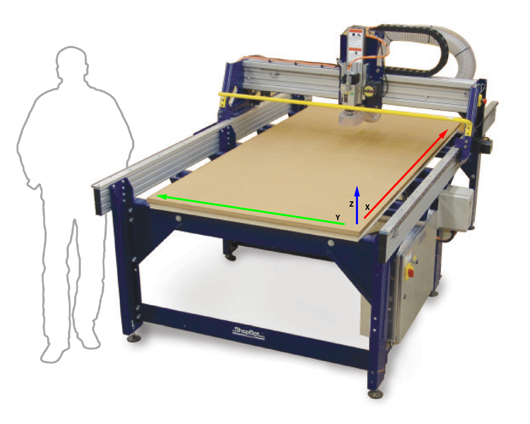

Step 3: Coordinate System
Coordinate System
Right Hand Rule: To be sure which axis is which, just follow the "right hand rule". With your right hand, make an L shape with you thumb and forefinger, then point your middle finger up. The axes are X, Y, and Z counting down from your thumb. Remember that Z should be up.
Like other digital fabrication tools, there’s a cartesian coordinate system with three axes - X,Y,and Z - associated with the machine. On the Shopbot, the long axis is the X-axis, the shorter is the Y-axis, and the up and down is the Z-axis. On the X-Carve, X is perpendicular to the controller case, making the origin on the lower left of the table.
A CNC machine cannot be successfully operated without an understanding of how coordinate systems are defined in CAM and CNC machines and how the systems work together. If you want to know more, please review Chapter 4 Coordinate Systems in the CNC Handbook at cam.autodesk.com.
We set up our coordinate system in the previous lesson to be consistent with that of the Shopbot.

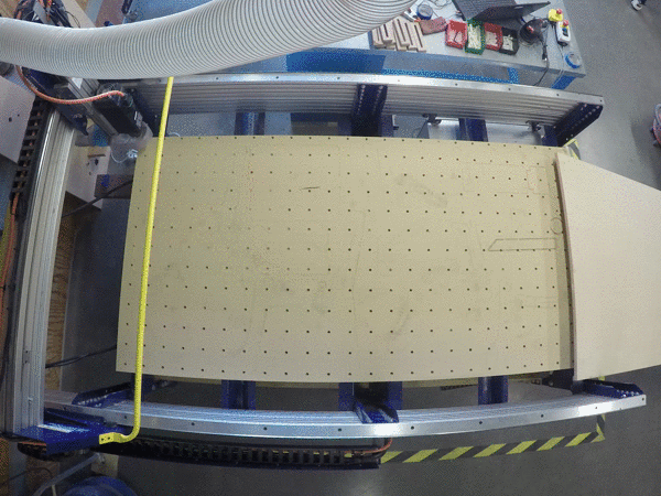

Threaded Insert System
The X-Carve comes with a pre-drilled spoiler board into which you drive threaded inserts.
In our shop, the table has a similar system with over 600 gridded holes, with threaded metal inserts. Nylon shoulder bolts are screwed into the inserts to hold materials, and wooden hold-down blocks with slots milled into them make it easy to hold stock of any size.
9/16" Ø holes are drilled by the Shopbot on a 4" X 4" grid, and 1/4"-20 thread size threaded inserts are screwed into the holes. 1/4"-20 nylon bolts are used to screw into the threaded inserts in conjunction with slotted blocks.

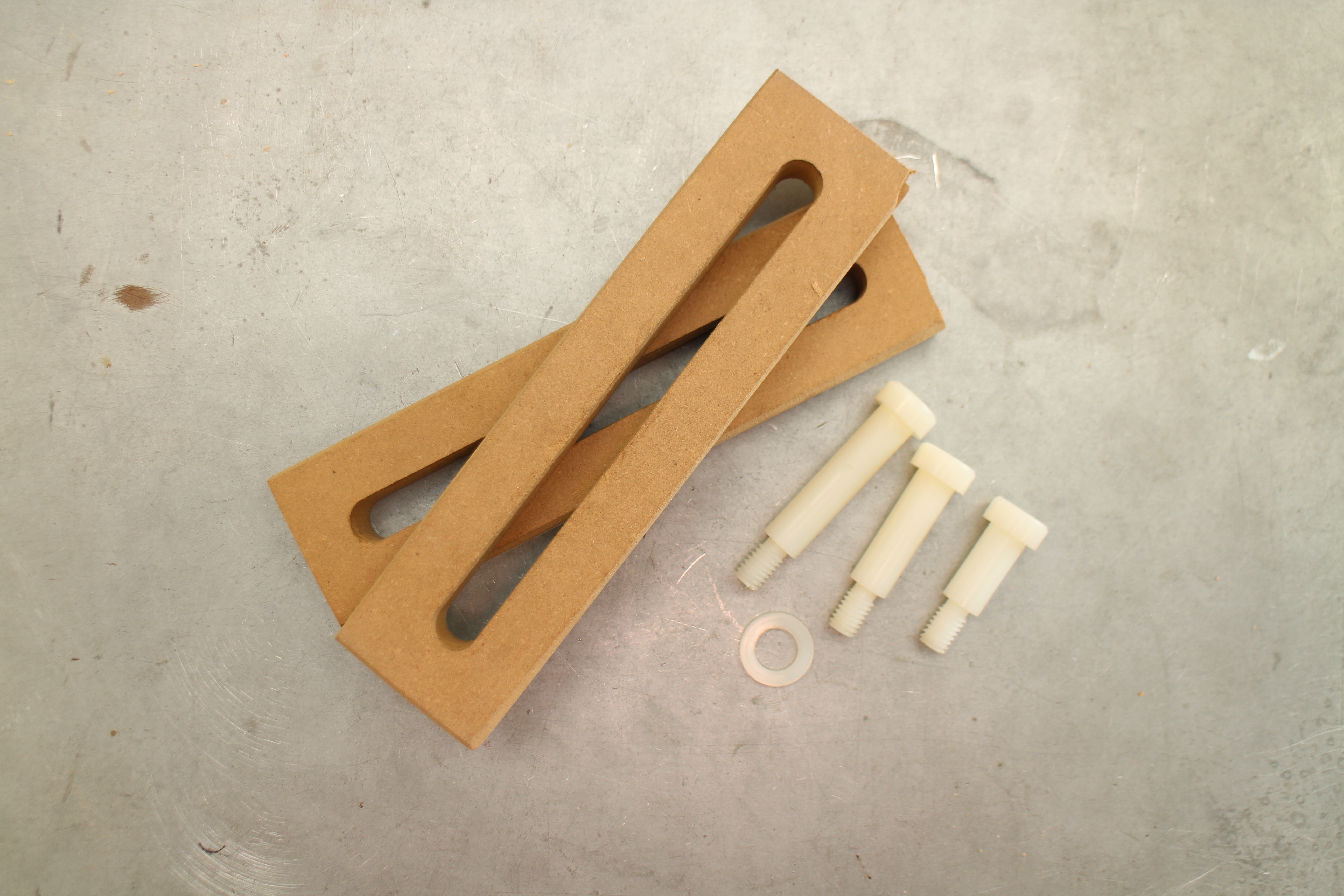

Using the Hold Downs
On one side, bolt down a registration block to ensure the stock is properly aligned with the Shopbot Axes. Then use hold downs on the other three sides to keep your material from pulling up.
- Put your material down on the Shopbot table. On one side, choose two holes near the material that are a few inches apart. Blow debris out with compressed air.
- Place a hold down block flat on the table, with the long edge flush against your material. Then screw the hold down block to the table with two nylon bolts, starting by hand and tightening with a wrench. Be careful not to overtighten more than ¼ turn so you don’t destroy the threads.
- Gather a few scrap blocks of your material or another material that is the same thickness. You can also use extra hold downs if your material is 0.5” thick. You will use these blocks to balance the back end of your hold downs when they’re placed over your material, ensuring that they’re applying force evenly.
- Choose where to place your hold downs—at least one on each of three sides and spaced at 3’ intervals—and then blow debris out of holes between your material and the scrap blocks. Screw a nylon bolt through each hold down and tighten with a wrench.

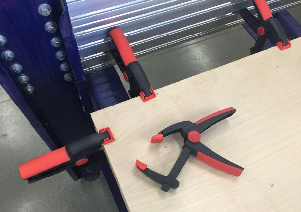

Holding Full Sheets
Full sheets (4' X 8') cannot be used with the threaded insert system because they cover the entire bed. For full sheets, use clamps around the edges to hold down the stock.
We use adjustable spring clamps in our shop because they only cover about 3/4" of the stock around the edge of the table. Trigger clamps also work well, but they cover more of the stock around the edges, leaving less usable space on the sheet. Here's how it works:
- Square the panel to the ShopBot table.
- Use clamps to hold each corner and side of the panel. Use a minimum of 8 clamps - one at each corner and one on each long edge.
- For sheets that are cupped or bowed, place the belly of the sheet down so the edges lift up from the table.

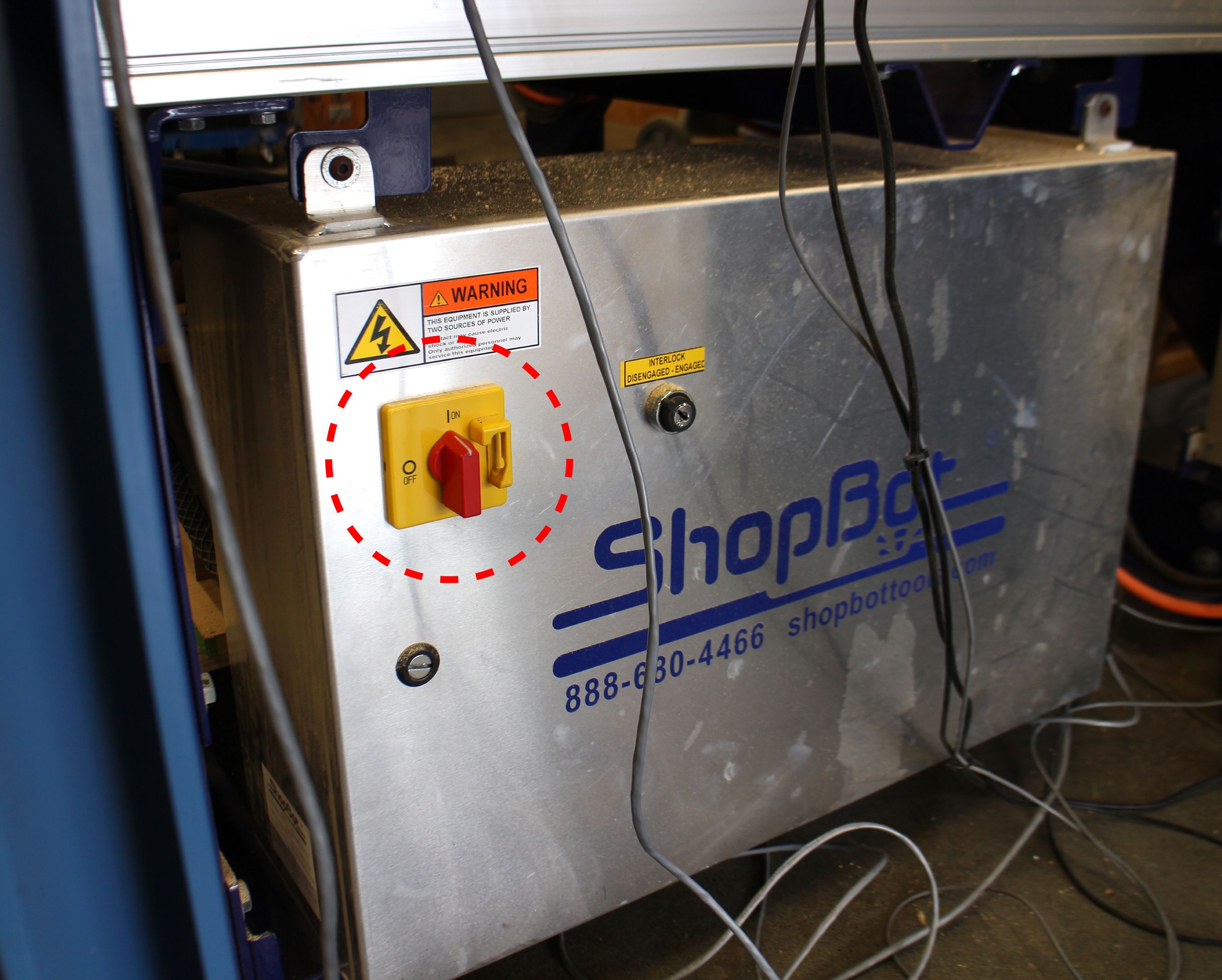

- Turn on the ShopBot.
- On the side of the machine, rotate the red switch clockwise to the ON position.

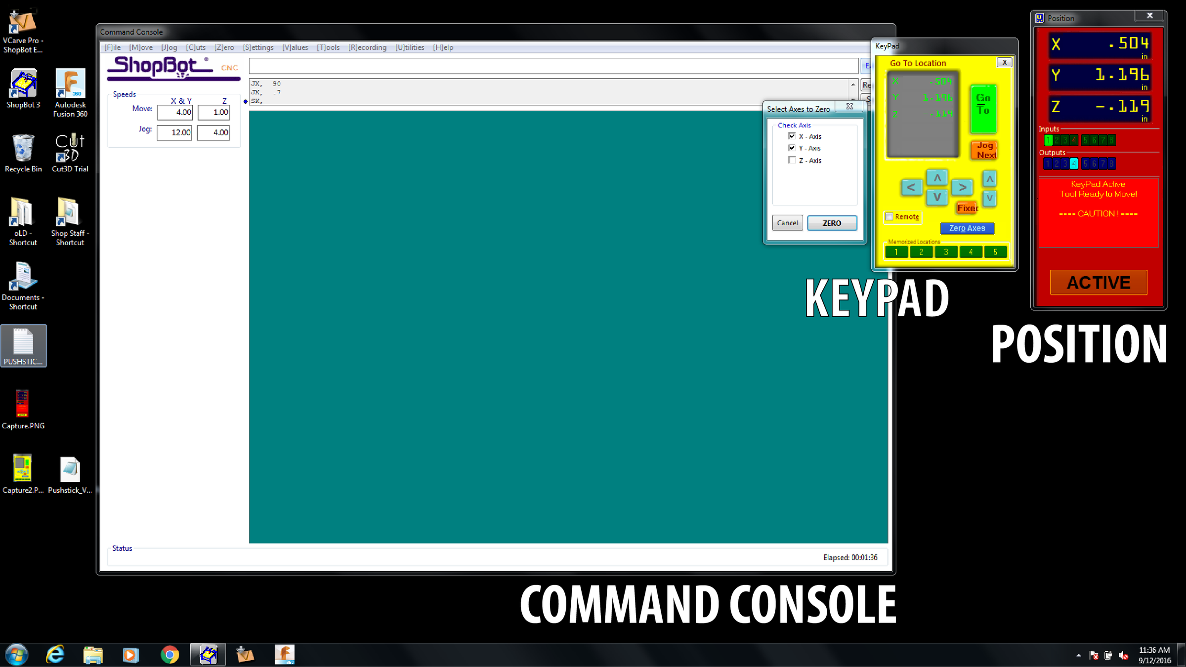

Command Console and Position
There are two windows that control the ShopBot: Command Console and the Position dialog box.
Command Console:
The window in the center, the Command Console, has standard drop down menus that contain commands. You can also enter individual commands to move the tool or run a part file. When the part file is running, this winow will scroll through the G-code./
Position Dialog Box:
The red Position dialog box on the right side of the machine displays X, Y, & Z coordinates and icons that set up and run the machine.

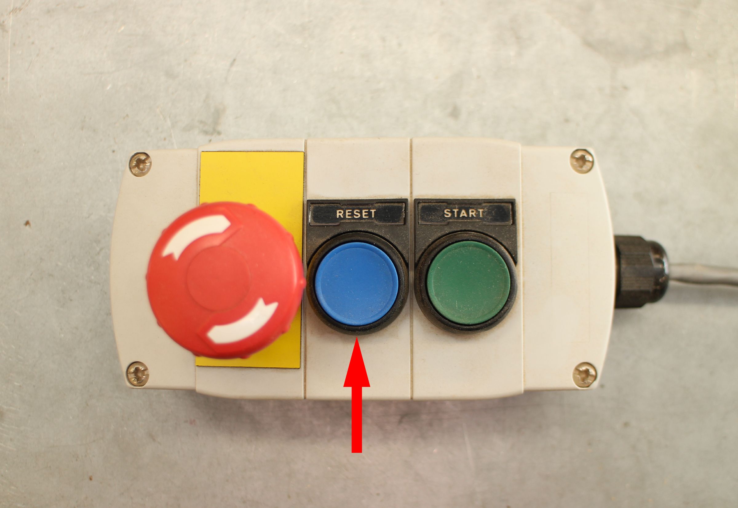

- Reset the stepper motors
- Press the blue Reset button on the pendant.
- Do not move the gantry by hand when the control box is ON.

To set the stock origin, move the spindle up in the Z axis to avoid crashing, then use the keypad to move the spindle in the X and Y dimensions in order to align the end mill tip with the origin point of the stock already fixed to the table.
Make a note of the X and Y position in the keypad. These numbers tell you where the spindle is in relation to the machine home. If something goes wrong with your job and you have to shut down the machine in the middle of a job, you'll be able to re-home the machine, then manually enter the values you recorded for X and Y location. This will allow you to continue the job without wasting the stock that was partially cut.
You won't be able to line it up exactly with the corner by eye-balling an end mill, but it will be close enough for a flat-pack project with a 1"+ margin around the edges of the stock.
Click on Zero Axes and check X-Axis and Y-Axis in the list, and the keypad will now read X=0 and Y=0.

- The machine will run through a few lines of code, and then a dialogue box will come up reminding you to start the spindle. The spindle does not automatically start: -Do NOT press OK yet.
- Press the Reset button on the pendant and press the Start button on the pendant to start the spindle

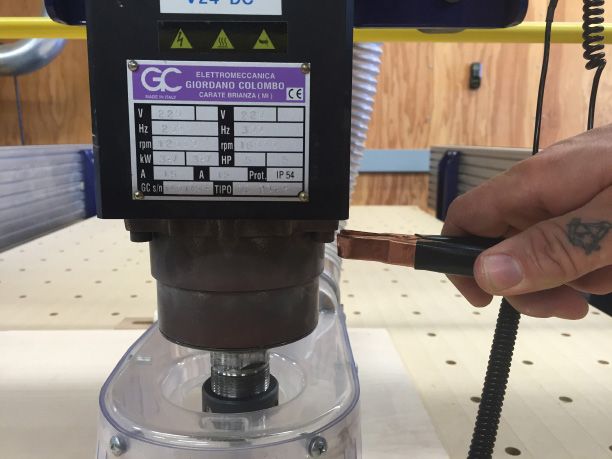

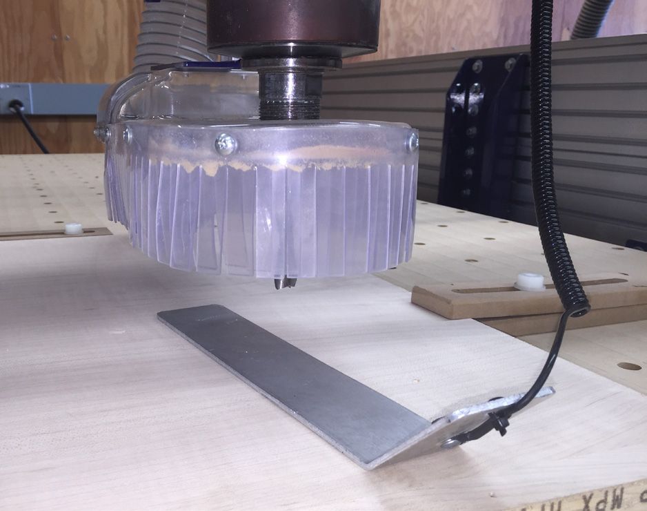

ZEROING WITH A ZERO PLATE
Some CNC routers are equipped with a zero plate. This is conductive metal plate with a thickness that's programmed into the machine's computer. You can run a command that will move the tool down until it touches the plate, then the software will automatically subtract the plate thickness and give you an exact Z height.
- Jog the spindle over your workpiece.
- Set the zero plate directly under the end mill.
- Attach the ground clamp to the standoff on the spindle.
- Close yellow control pad.
- Click Cuts in the top menu and then choose Zero Z Axis with Zero Plate. (keyboard shortcut C2)
- Press enter when ready to zero.
- When done with the z plate remove the ground clamp and zero plate.

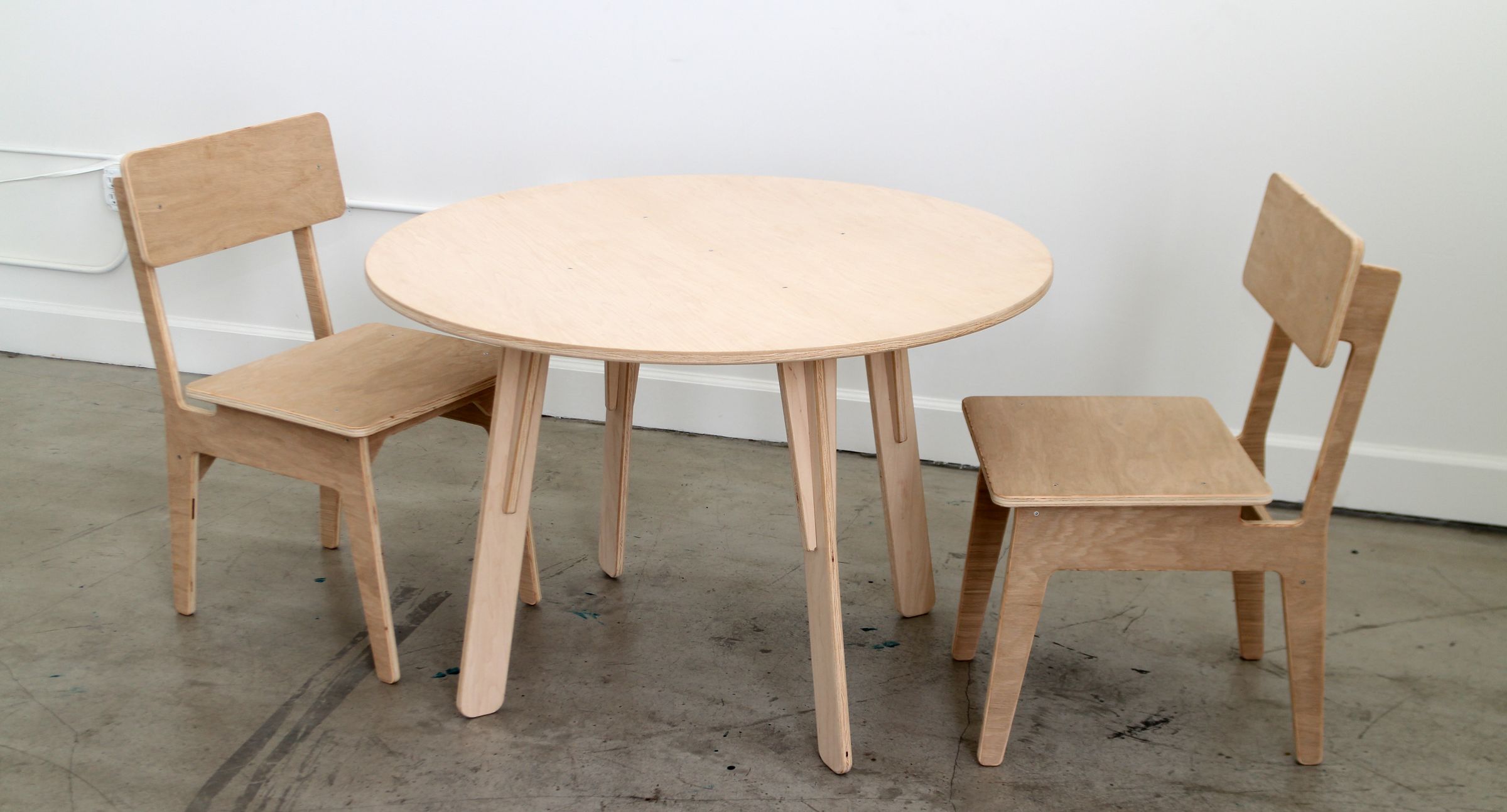

Step 9: Assembly
Step 10: Finished Product
If you made a CAM setup for the chair file, you can make a whole dining set!
If you stayed with us the whole way through, you've learned enough about CNC to get going on your own projects. Remember that this kind of work takes lots of practice and you'll probably make a lot of mistakes the first several times you make projects.
Stick with it, keep practicing, and pay close attention at every step. Keep experimenting, and you'll get more comfortable every time you use the machine.
