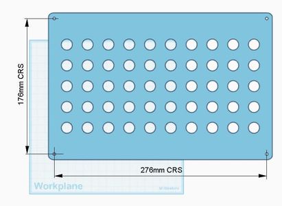

I needed to make a number of rectangular plates each with 50 holes, I do not have the facility to 3D print them in one piece so I bit the bullet and invested in a FoxAlien Masuter pro CNC router. Long story short having built an enclosure/dust extractor/demidifier for it, the time came to carve something.
Zero on the Z axis was easy, as simple as a piece of paper or I could have use the provided setting block.
I set zero for X & Y by jogging the tool to the corner of the plate to be cut and sent the router on its way.... well part way through something went wrong and I heard a noise that said to me something had slipped so I stopped the cut. I returned to zero and sure enough the cutter was in the wrong place.
Not a problem, just reset X & Y zero and away we go again...... my zero was around 0.3mm out in one direction and though the plate was rescuable, I realised a more accurate method would be required for setting up to carve.
