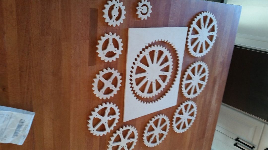

I downloaded Gear Generator (http://woodgears.ca/gear/) for $26 to make this real easy. It draws gears with any number of teeth, inside or out. You can add spokes in any number, and it outputs in .dxf, a useful format. It is also quite fun and very easy to play with.
After generating the ring and gears of various sizes, I saved the files and imported them into my CAD program. I needed to make holes for the fine-tip Sharpies to be placed. After measuring the diameter of the tip of the Sharpie at .15”, I began to place the holes on the spokes at various distances from the center point of each gear. It became obvious that to beef up the narrow wood next to the holes, I would need to widen that part of the spoke. I created a series of ½” circles and placed them concentrically over each Sharpie hole to beef the up wood. Next, I clipped out the extraneous vectors and cleaned up all the images. Thus I had a vector drawing of all the parts on the minimum sheet size. I then cut the 5’ x 5’ Baltic birch plywood into the size needed, 16” x 21”.

On our homemade CNC machine, is a Porter Cable Trim Router. It will accept ¼” shank bits, and with collets, will size down to 5/32” and 1/8” shank tooling. As I had selected Baltic birch plywood, I chose a ¼”shank 1/8” end mill. This means it is strong (thicker shank), and will cut 1/8” wide with a square bottom.
Our router only goes one speed in rotation and maxes out at 25 linear inches per minute, so the only control we have is how deep it cuts per pass, and the inches per minute speed it travels thru the material. Before any machinery is turned on, install the bit into the router you have. Be VERY careful, they are quite sharp. I wouldn’t know that, but there are a wide range of band aids and compresses readily available in our shop, just in case.

I used an X-Acto to clean up feathers left from the cut
Using foam-sanding pads, I smoothed all the surfaces, especially the teeth
I cleaned the gears with air and a brush.
I didn’t feel that stain would improve the look.
Finished with spray polyurethane. Do this outside and wear a mask anyway.
