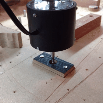

There are numerous tutorials available describing how to make your own CNC touch probe. My final probe design combined concepts from several sources into something I thought I could make. I machined what parts I could, but for the most part I did not have the right tools to manufacture the required parts. I do not have access to a lathe or drill press, so there was much dremeling, hacksawing and cordless drill shenanigans. This manufacturing process, in conjunction with less than ideal materials and a $3 collet, culminated in a wildly inaccurate probe.
By the end of this instructable we will transform the probe you see gyrating below into a usable tool.
-Wobbly spindle probe

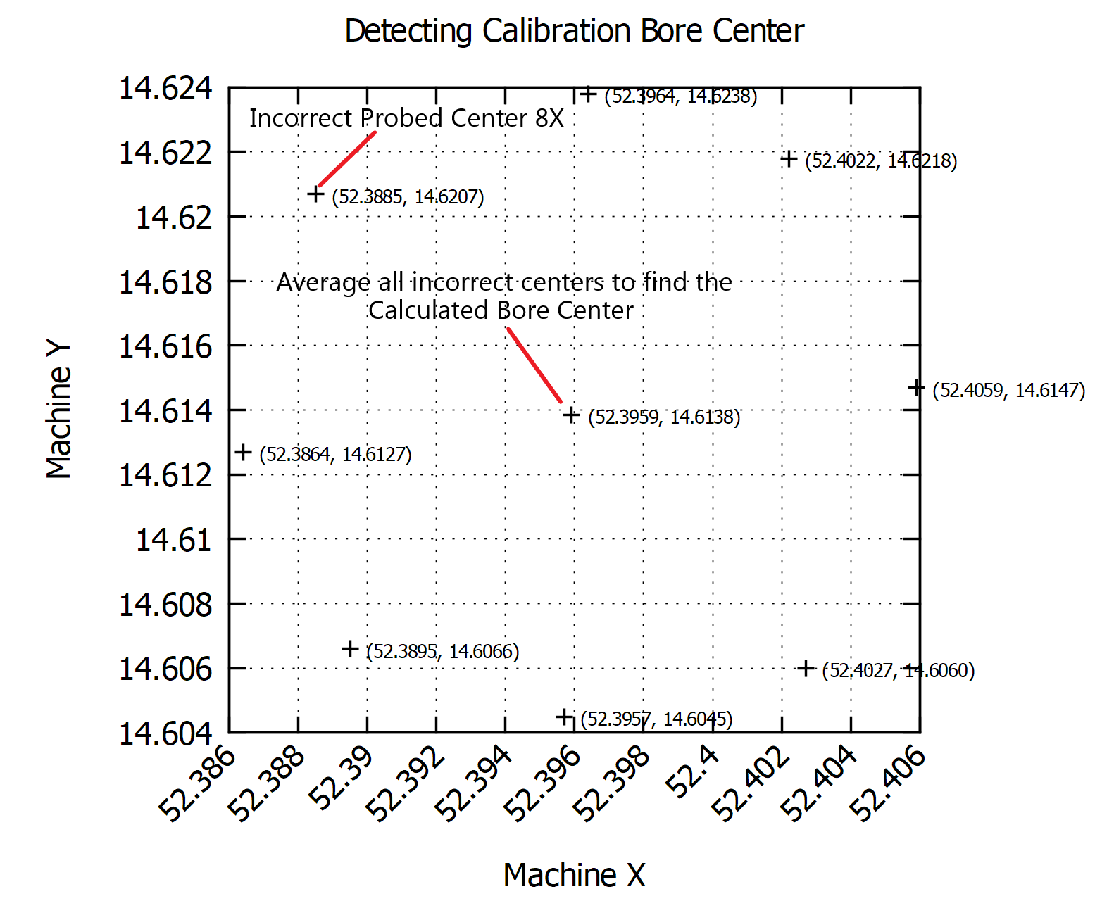

Now it is time to find the true center of the calibration bore. The idea here is to use the uncalibrated probe to get a point cloud representing the bore. Then take the average of the point cloud to get the true bore coordinates.
I measured my point cloud by running basicProbeBore.ngc with the probe inside the calibration bore and rotating the spindle 45° for each data point. The gcode outputs the perceived center coordinates. I recorded all these points and averaged them finding a true center of:
x=52.3959 and y=14.6138

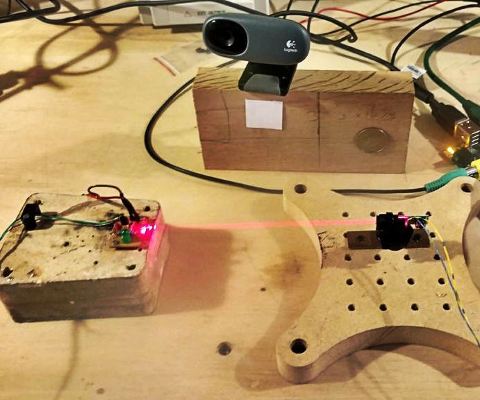

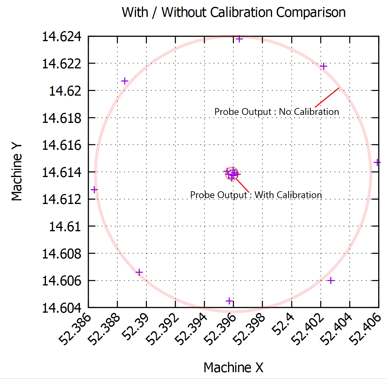

After the test of concept video I measured the unknown bore at 45° increments. Before each measurement I recalibrated the probe (hopefully removing the wobble error). The results should indicate how much my accuracy had increased.
During each data collection point I took a photo. The video above shows these points in timelapse form (be sure to set the video to loop and HD). There are detail views showing points of interest. The one we are really concerned about is the upper left being completely stationary (indicating the spindle is in the same position above the work piece regardless of probe orientation). There might be a small wobble, but it is nothing like what I had before. The difference is night and day.
Below is a chart where I plotted the effect of the calibration constants.

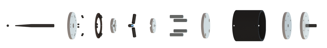

Step 7: Bonus: Probe Design
Here is the model and general plan of the probe. The model doesn't show all the details as I chased a lot of the holes by hand with csink and tap.
