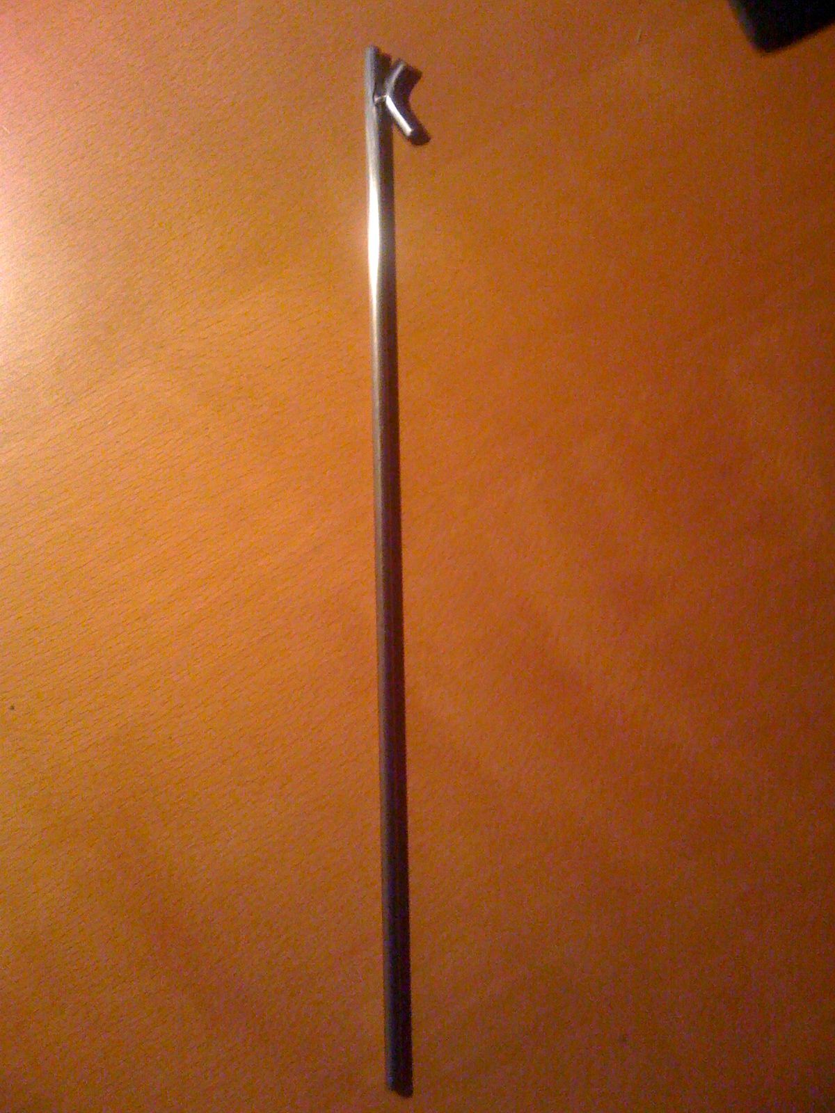

First of the wrong way to do it, is by using a simple threaded rod and bolt, they are easy to get, cheap and it will be the death of your hard work since you will be changing these as often as you would change a cheap second hand lightbulb with water in it. They simply was not made for that kind of use and the threads will tear very fast, and increase backlash as they do it. Treaded rods and bolts are for bolting your things together and making sure they stay where you want them, and they are good at it, so use them as intended. If you must use a threaded rod, at the very least use a copper bolt.
