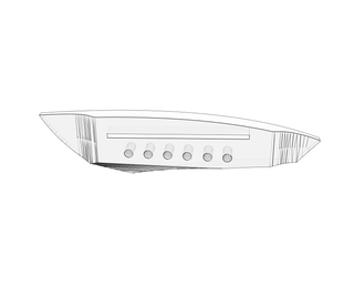

Step 2: Design the Bridge - Drawing / Tracing
I thought about designing my own bridge from scratch, to go with the custom look of the rest of the guitar. But I wasn't sure how that might affect the final sound of the guitar, so I decided to go with a tested design from an existing builder.
I wanted something a bit different from the standard designs, and after looking around online I really liked the look of asymmetrical bridge bases. Also, given the free-flowing image on my soundboard, I wanted a design with complex organic curves instead of a flat base. I used google images to search for bridge designs, and the one that jumped out at me was that of Bashkin Guitars. I liked the flowing edges and asymmetrical design.
I couldn't find any existing 3D models of them, so I traced a photo and tried my best to form my own 3D version. I've included a .STL model of my bridge, as well as an outline of my bridge shape with slot and pin holes.
Tracing the shape
- First, I made a new file and created a block the size of my bridge blank.
- Next, I started a new sketch on the top face of the block I just made. I found a good top-down photo of the Bashkin bridge on this site and imported the photo into my sketch.
- I used the spline tool to trace the edges of the bridge. I finished the sketch once I was happy with the 2D shape.
- I used the extrude tool to pull away all the material outside of my tracing, leaving only the bridge shape.
- I then made another sketch on the top of the new part to improve the slot and pin hole placement, based on an illustrator file one of the instructors had used on their guitar.
- I tried to import the Illustrator vector lines directly, but only some of the shapes worked, and the results were very buggy, I'm still not yet sure why. So instead of using the vectors, I just traced this image as well, using the circle tool for the pin holes, and the line and arc tools to trace the slot.
- After tracing the holes I used the extrude tool to cut the shapes out of the bridge
Shaping the sides
- In the left menu, I selected the XZ plane to make a new sketch
- Looking at the bridge from the front, I used the spline tool to make the profile I wanted. I had to make sure the contours of my profile didn't cut into the slot and pin holes.
- Once I was happy with the profile, I finished the sketch and used the split form tool to cut out the profile from the part.
- To cut out the section at the bottom, I did a similar operation on the YZ plane. I sketched a curve just to the side of the bridge, then used the split part tool to cut away the bottom of the bridge.
Design notes
- I purposefully did not cut out the pin-holes to their full size. Guitar pins are usually tapered, so that they wedge into the hole and hold the strings in place. I wasn't confident in my ability to accurately model this taper, so I cut the holes to the smallest size of the tapered pins, then drilled them to full size by hand.
- The same things goes for the saddle slot - it's just a hair smaller than my saddle bone blank. I later used a file to cut away the slot until the bone JUST fit inside.
- The saddle slot is supposed to be slanted. From what I understand the bass strings bend differently than the treble strings when playing, thus the slant helps them keep the same effective distance from the saddle.
- So far my bridge seems fine, but the person who gave me the slot and pinhole layout said they were not happy with the setback of the bridge pins - they wish they had put them further back. They are worried there is too much pressure on the saddle bone from the strings being installed at a steep angle. Consider this in your own design.
