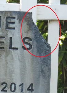

Now that you've carefully crafted a nice neat tombstone it is time to beat it up and make it look old. You can break off a chunk, sand it, use a rasp or chisel. The important thing is to make it look like it aged naturally over a few hundred years and this takes practice. But we don't have a few hundred years so here are a few tips.
- start small and try things out on a scrap chunk of foam first

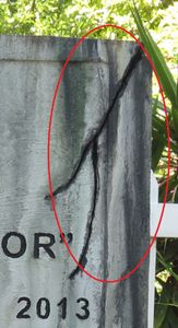

- a hot soldering iron and a shaky hand make for nice cracks
- rather than "breaking off" a chunk, try the soldering iron. The heat helps melt the foam giving it a natural worn look
- a wire brush, especially on a drill, gives a nice texture like natural spalling of cement. Brush a few square inches (paint later) and it will look like a surface layer chipped off. Add some spackle around the edges of the region to make it blend with the normally smooth foam.

Now for the fun part. Adding the aged look. Gather your paints, brushes, water and spray bottle. It is best to start on the back for practice, but don't worry, you can undo almost anything without ruining it. Lightly dab small spots or vertical streaks with black or brown paint (diluted after you have some on your brush). Then spray with a little water and get some or all of it to run down. Repeat many times starting the dabs or streaks where rain might naturally fall and collect dust and grime, especially near edges or cracks made in prior steps. Be sure to cover all sides and the top. If you think there will be someone digging up from below make sure to paint the bottom as well. If you want, add more cracks with your soldering iron, paint the inside black, spray with a little water and watch before your eyes as your tomb ages 20 , 30 even 100 years in just 5 or 10 minutes. Use small amounts of green to add a bit of lichen growth on the top, in cracks and other places and spray lightly. Allow to thoroughly dry.
The entire aging process can be seen in a time lapse video in the SampleAging file
Finally dry brush using a light gray paint. Dab tiny amounts on a dry brush and wipe most of the paint off on a rag or paper towel. I mean wipe 90% off. Then quickly and lightly brush the very outer surface with long full vertical strokes. Be especially careful to not get too much in one area...but make sure and get some on the darker areas to highlight the dark stains. This gives a nice realistic stone texture. Note the red oval area in the photo for a good example. If you mess up, just wash off and start again.
