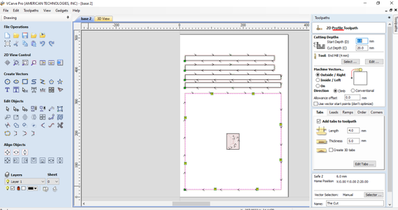

  • If you're using a CNC router to cut the wood, set your corresponding toolpaths to "Profile" and the machine vectors to "Outside/Right". Make sure to add tabs evenly distributed around the edge.
  • If you're using a CNC router to cut entry hole(s) into the sides of the cat box, set set your corresponding toolpaths to "Profile" and the machine vectors to "Inside/Left".

  • The slot for holding a box should be slightly bigger than the bottom of the box (e.g., a 31x31 cm hole for a 30x30 cm box).
  • The slot accommodating a scratching pole should be a friction-fit mortise-and-tenon joint (e.g., a 4x5 cm hole for a 4x5 cm pole). This slot should be on your base piece and your perch piece.
  • Both types of slots should be at least 1cm deep.
  • If you're using manual power tools to cut the wood, measure and mark the holes you'll be making.
  • If you're using a CNC router to cut the wood, set your corresponding toolpaths to "Pocket".
