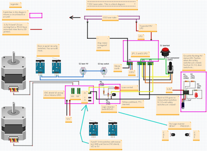

One problem I encountered during the investigation for this build on how to let the CO2 laser fire at wil. Because the Arduino has a positive TTL output signal, and the LPU needs a negative TTL signal to fire the laser. The solution I found was a logic inverter! This does the trick!
Pic 1: the logic inverter circuit.
  • The left yelow and black wires are TTL output wires coming from the CNC shield
  • The rigth yelow and black wires are the inverted signal wires going to the LPU (JP3 on pic 3)
  • The LED with the ballast resistance, R5, are not necessary. I add them because I like to see what is going on.
Pic 2: Two different transistors you can use for the circuit. Watch the difference in pin lay-out
Pic 3: The LPU I use is the one with the 4,6,4 connector config. On JP3 you see the inverted signal lines going in.

Step 13: Complete Block Diagram
This is the complete block diagram.
The Fritzing file is added to download to see more detail!
