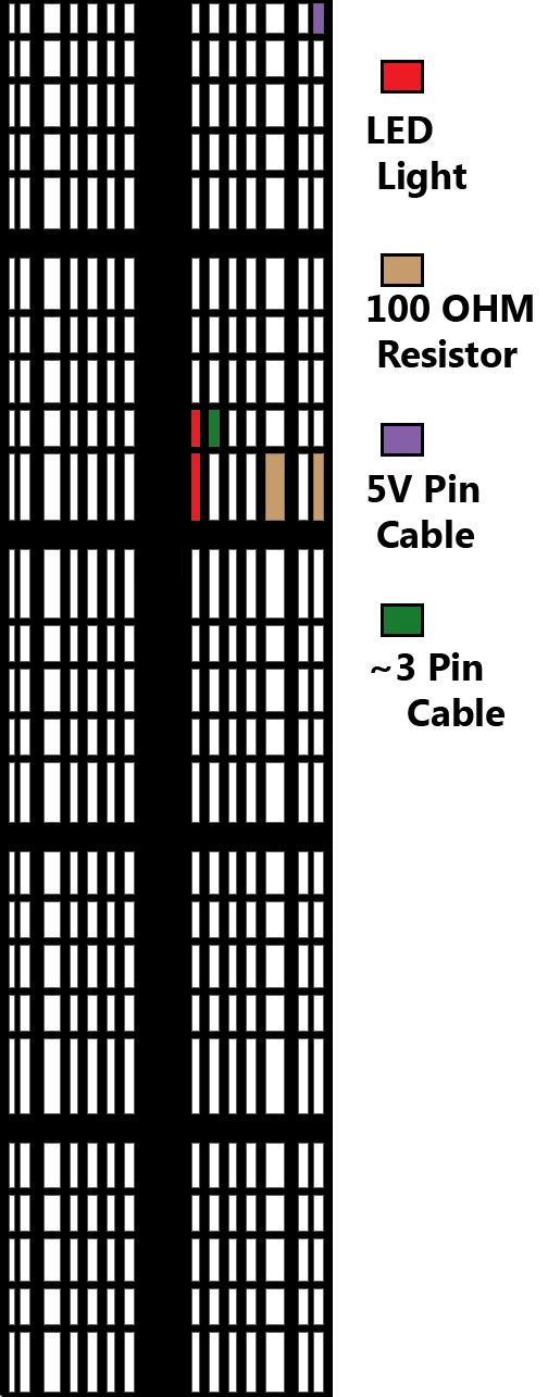

- Plug your Grove base shield into your Edison.
- Plug jumper cable into I2C port (which one doesn’t matter). Plug other end into RGB Backlight LCD.
- Plug jumper cable into D7 port. Plug other end into button sensor.
- Plug jumper cable into A0 port. Plug other end into light sensor.
- Plug pin cables into 5V port (by the I2C ports) and ~3 port (by UART port).
- Wire LED and 100 Ohm resistor in series from the 5V port to ~3 signal. (Check bread board diagram and set up accordingly.)
