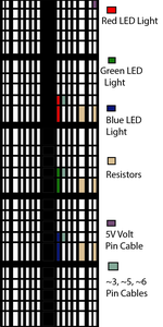

- Plug 1 of the jumper cables into the 5V port on the Edison. Connect to the bread board. (See picture for reference. It's the blue cable closest to the 12C cord you just plugged in.)
- Plug other jumper cable into port A0. Connect other end to Rotary Angle Sensor.
- Plug other 3 jumper cables into ports ~3, ~5, and ~6. We will connect these to the red, green, and blue lights respectively.
- See diagram of bread board for details on what wires go where.
