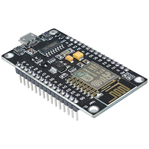

  1. Node MCU

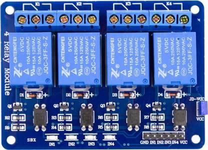

  2. Relay Board

The circuit is very simple as we are only connecting the Relay board to Node Mcu
Connect to Relay board GND to Node MCU GND
Connect to Relay board VCC to Node MCU VCC
Connect IN1 IN2 IN3 IN4 PINS of Relay Board to D0 D1 D2 D3 of Node MCU
