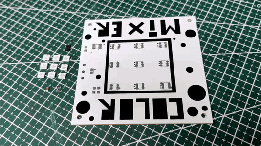

Step 2: PCB Design- LED Board
Let's have a look at the front PCB's LED Board, which houses the WS2811 IC and 9 5050 Package RGB LEDs that are all connected in parallel.
The I/O pins of the WS2811 IC are linked to the Red, Green, and Blue pins of RGB LEDs, as well as a few other necessary components like a few resistors and a capacitor.
In order to add an MCU for powering and operating the LED Board, the WS2811's Din port is connected to a CON1 port, and VCC and GND are also attached to separate CON1 ports.

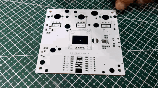

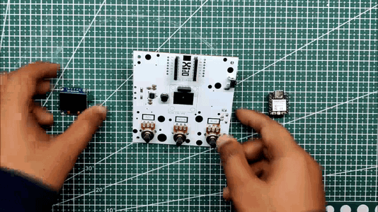

Step 3: PCB Design- Control Board
The second PCB is the control board, which, as its name suggests, uses a microcontroller and potentiometers to control the LED board.
Additionally, it has a lithium-ion battery that is connected to a Power Management IC (IP5303), which boosts the battery's 3.7V voltage to a stable 5V for powering the XIAO MCU, the OLED Display, and the RGB LEDs.
Three Pots are connected with XIAO M0 Dev Board's IO Pins D0, D1 and D2.
The SDA and SCK pins of the OLED display are connected to D4 and D5 pins of XIAO.
The IO Pin D3 of the XIAO is connected to the CON1 port; this IO Pin will be used to control the Din Pin of the WS2811 IC.

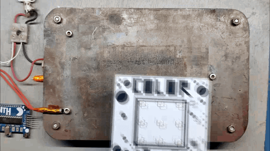

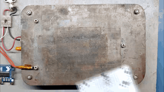

Step 5: LED Board- PCB Assembly Process
  • We start first with the solder paste dispensing process by adding solder paste to each component pads one by one.
  • We then used an ESD tweezer to carefully pick and place all the SMD LEDs and components in their assigned places one by one.
  • After the "pick and place process, " we carefully lifted the whole circuit board and placed it on the Reflow hotplate.
The hotplate heats the PCB from below up to the solder paste melting temperature. As a result, the solder paste melts and components get solder on their pads.

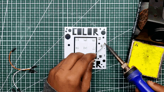

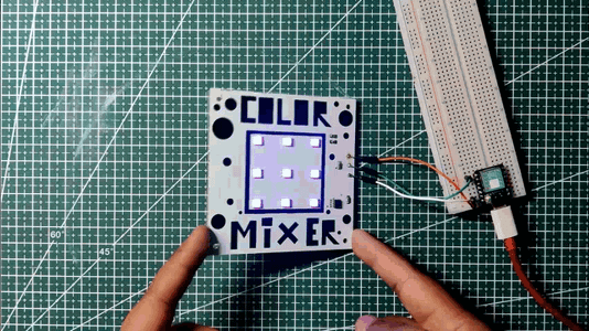

Step 6: Testing the LED Board
The color board is then prepared so that it may be connected to the XIAO MCU for the testing procedure.
When I say "prepare," I mean that we add jumper wires to the board's three CON1 ports by using a soldering iron.
Step 7: Test Sketch
Then, using a breadboard, we connect the Din pin of the WS2811 to the XIAO M0 development board, the VCC of the LED board to the XIAO M0 development board, and the GND of the LED board to the GND.
Then we connect it to the Arduino IDE and upload the below sketch into it.

You must install the Neopixel Library before uploading this sketch because it is based on it.
https://github.com/adafruit/Adafruit_NeoPixel
Also, the #define PIXEL_COUNT 1 is set to 1, which means only one pixel is being controlled on this LED board.
However, this LED Board has 9 LEDs, so why do we use just 1 pixel? No matter how many LEDs are installed in parallel or series, or even in the SMD version of addressable LEDs, each LED has a single WS2812 or 11 wafer that is internally connected to each R, G, and B pin in the IC, hence the single LED or single chip is declared as 1 pixel.

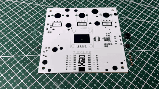

Step 8: Control Board- PCB Assembly Process

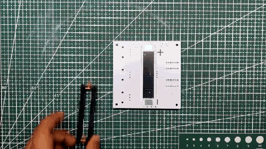

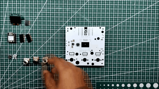

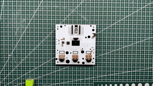

  • Next, we prepare the Control board by first adding solder paste to all the SMD Components Pads
  • We then Pick and place all the SMD Components in their location with help of an ESD tweezer.
  • Next, we carefully lifted the whole circuit board and placed it on the Reflow hotplate.
  • After reflowing the hotplate, we attach the SMD Lithium cell 18650 Holder on the bottom side of the board.
  • At last, we place all the remaining THT Components which include Potentiometers, header pins, Vertical switch, and USB Port to the Control board and then use a soldering iron to solder components in their place.

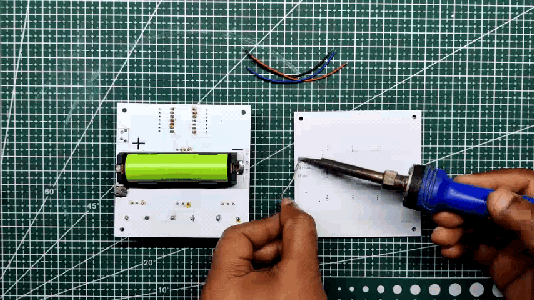

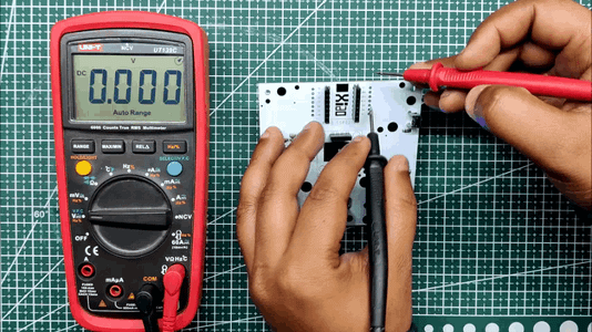

Step 9: Testing the Control Board
After setting up the control board, we place the lithium cell in its holder and turn on the power management IC by pressing the vertical switch. This indicates that the circuit is functioning, and since the voltage across the VCC pin of the XIAO and the GND shows to be 5.1V, the circuit is functioning.

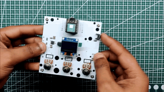

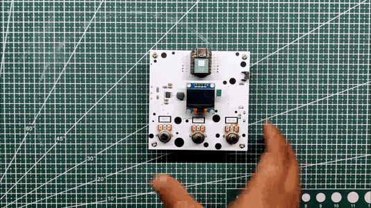

Step 10: Adding XIAO and SSD1306 OLED to the Control Board
After making sure that the onboard power management circuit is working, we place the XIAO board and OLED screen in their respective locations.

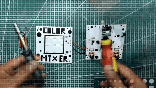

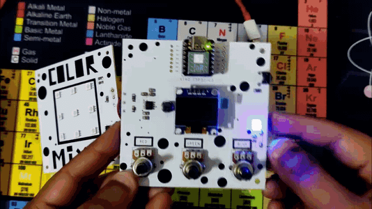

Step 11: Adding LED Board and Control Board Together
Next, we solder the VCC, GND, and Signal lines—the D3 Pin and Din Pin—of both the LED Board and the Control Board together. This completes the connection between the two boards.

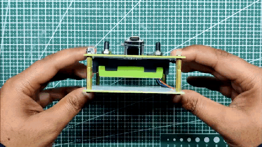

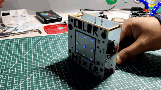

Step 13: Final Assembly
The final step is to join the two boards together using four PCB Standoffs, which keep the two PCB intact and create a solid box-like body when fastened in place with nuts and bolts from both sides.

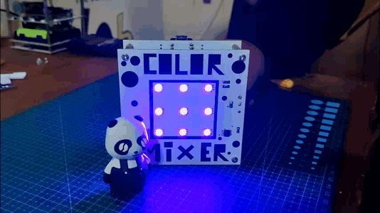

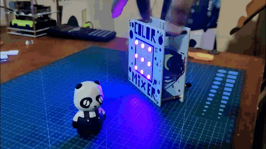

Step 14: Result
Here's the result of this build: a working RGB light source that is completely DIY and made by using stuff that I had, so no additional parts were purchased, and the cost of this project is super low compared with the actual RGB lightbox.
Step 15: Problems With This Version
As you can see, the setup's light is not quite half as strong as that of the earlier Color Mixer project.
This is due to the fact that a single WS2811 IC, whose maximum current output for each RGB channel is 18mA, is being used to drive nine LEDs in parallel.
I missed this information in the datasheet, and it was a frustrating oversight that I subsequently discovered.
https://cdn-shop.adafruit.com/datasheets/WS2811.pdf
This problem will be fixed in version 3 of the project. however, for the time being, the Setup is functional and fairly useable.
The next version must have an increase in light as a necessity.
