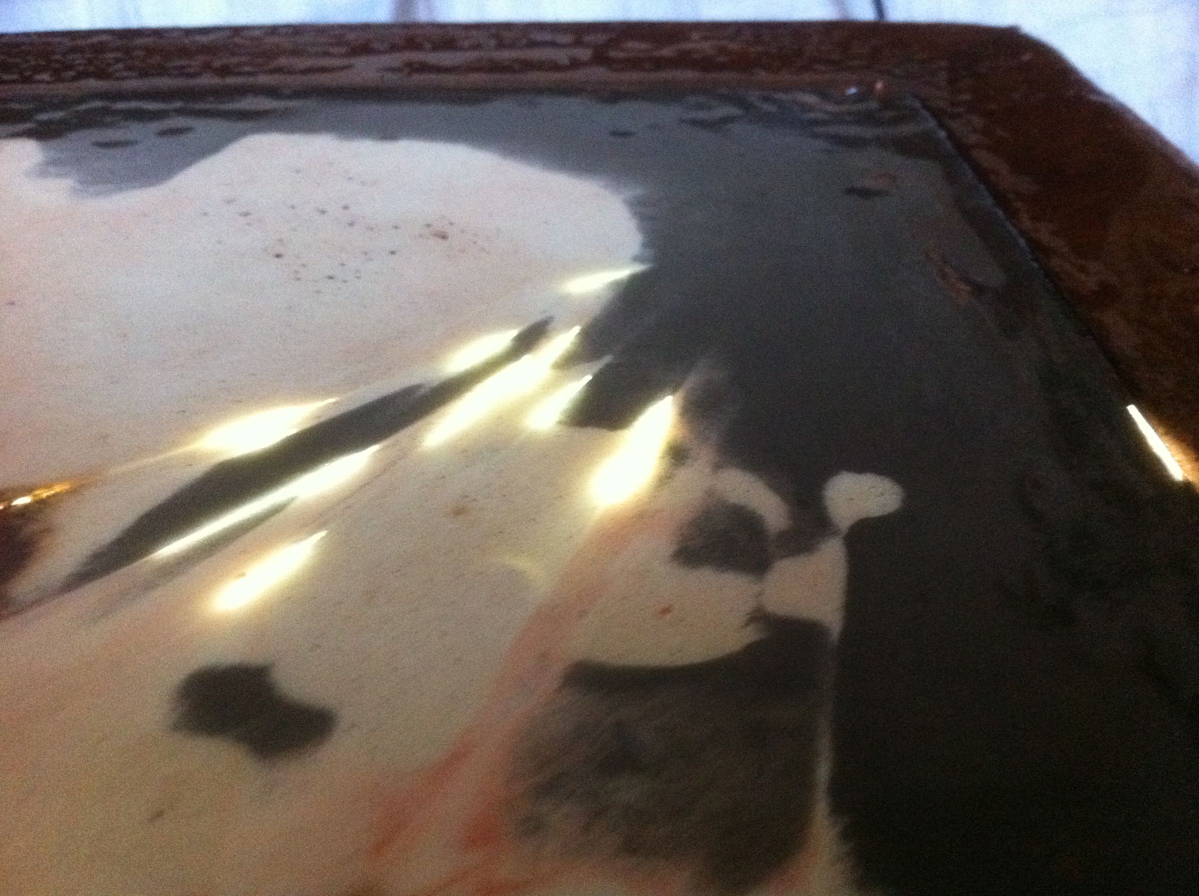

Step 1: Fabric Forming
I use some fabric, a stapler and my wooden template. I fix my fabric thanks to staples. Once the tense fabric, we throw the resin above, the resin tinged for controler the thicknesses.
After drying we shall sand the mold in the paper 120, then 240 then 400, then we shall pass in the sanding in the water up to a perfect glassis.
There is not more than to apply the gfrc to the mold, seen the quality of finish of the mold, the sanding of finish will be light.
