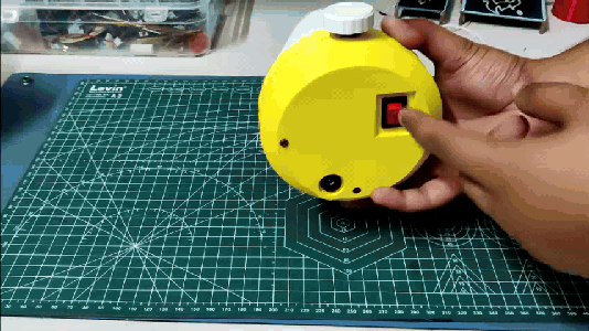

3D Design of this CONE LAM consists mainly of two parts, the base and the cone diffuser.
The base of this Lamp will house the Battery and electronics and also contain a Knob for the potentiometer; this knob will change the HUE of the lamp. Additionally, the base contains the LED Holder, which is a square pillar or a pipe-like structure that is used to hold the LED PCB inside the Cone diffuser area.
The whole model was modeled in Fusion 360 and 3D Printed using Yellow PLA and white PLA.

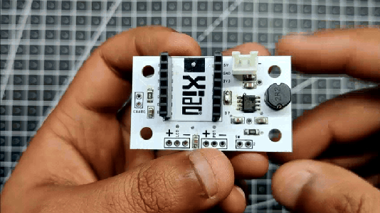

The Power Board and the RGB LED Board are the two different boards that make up PCB Design.
The IP5306, a Power Management IC that is commonly used in power bank-related applications where we have a 3.7V Li-ion cell and need to boost its voltage to a stable 5V for XYZ stuff—in this example, the XIAO M0 MCU and LEDs—makes up the Power Board, a minimal Circuit.
The XIAO M0 MCU is also installed on the power board, and two headers are connected to its 5V, D0, D1, and GND pins via two headers. Potentiometer and LED PCB connections with XIAO are made using these two header pins.

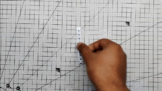

The LED Board consists of a straightforward WS2812 LED configuration connected in pairs of eight, with eight capacitors added to the VCC and GND of each LED, respectively.
A pair of 32 LEDs will be connected by a single digital pin on a total of four of these LED Boards, which will be connected to the XIAO MCU.

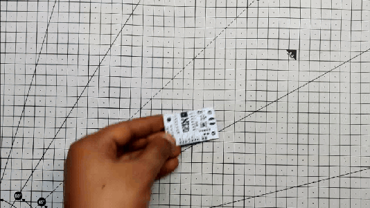

Both the LED PCB and Power Board PCB were sent to SEEED Studio for samples.
Two orders were placed for a White solder mask with Black silkscreen, and the PCBs arrived in less than a week, which was super fast.
The quality was very good considering the price, which was also pretty low.

Next, we prepare for the LED PCB assembly process.
Step 4: LED PCB Assembly Process

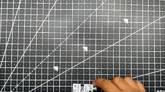

This project's PCB assembly process consists of two PCBs, the LED Board and the power board, We first start with the assembly process of the LED Board.
  • We begin by applying solder paste to each component pad individually using a solder paste dispensing syringe. We have to use four LED PCBs in this project, so we had to apply solder paste to all four PCBs.
  • Next, we pick and place all the components, which include the LED and capacitor, in their proper places using ESD tweezers.
  • Following the pick and place process, we place this board on a mini reflow hotplate, which heats the PCB from the bottom up to the solder paste melting temperature.

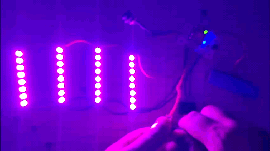

Step 5: Testing LED PCB Board
In order to test the LED Board, we connect them together according to the given wiring schematic and connect them together with the Xiao MCU using jumper leads.
We programmed the Xiao MCU with Adafruit's Neopixel LED Test sketch, changing the Pin number to D0 and the quantity of LEDs to 32. In order to extend the LED's life, we also reduced the delay time from 500 to 100 or less.

Step 6: Power Board PCB Assembly Process

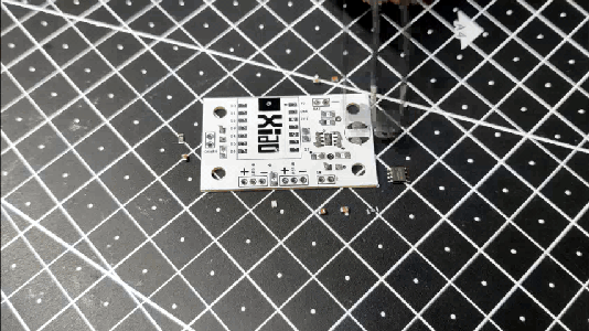

  • We Now apply solder paste to each component pad individually using a solder paste dispensing syringe.
  • Next, we pick and place all the components in their proper places using ESD tweezers.

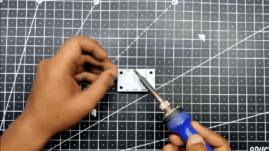

  • Then we put all of the THT components in their proper places, such as the header pins in the XIAO pads and the battery connector.
  • We use soldering iron to solder the Header pin in its place and the PCB Assembly is complete.

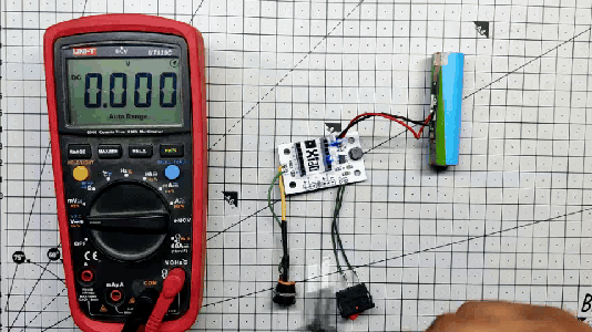

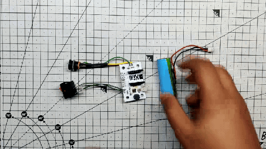

Step 7: Testing Power Board
In addition to connecting a rocker switch to the XIAO Board so that the power board can be turned ON and OFF, we also add a DC Barrel Jack for charging the Li-ion battery.
Once the rocker switch and DC jack have been soldered, we can attach a Li-ion battery to the Power board's CON2 Port and turn on the rocker switch to turn on the Power board and illuminate the status LED.
The voltage between the output ports of the IP5306 IC will be 5 volts at this point, indicating that the circuit is operational.
Also, a conventional USB cable is cut and a male 5mm barrel jack connection is attached with the positive and negative wires of the USB cable to charge the Li-ion battery. This arrangement is then charged using a standard smartphone charger using the Makeshift USB-Barrel Jack Cable.

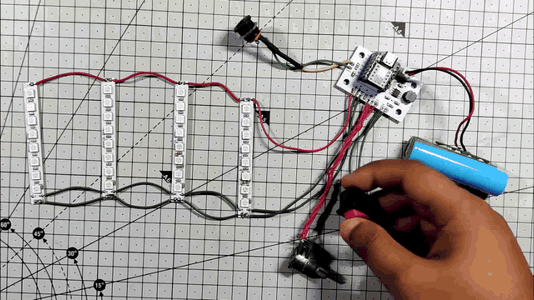

Step 8: Wiring
The wiring for this arrangement couldn't be simpler; first, we link the parallel-connected LED boards to the power board's VCC, then we connect the D0 pin to the first LED board's IN port, the second LED board's OUT to the second LED board's IN port, the third board's IN port, and so on.
Together with the battery, the rocker switch, and the DC jack, the potentiometer is also connected to the power board.
By following the given wiring diagram, we connected all these components together and uploaded the main code to the XIAO M0 Board.

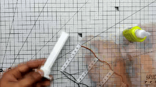

Step 11: RGB PCB Holder Assembly
  • Super glue was used to adhere the PCB to each side of the LED Holder after first desoldering the LED PCB from the power board arrangement.
  • Using three M2 screws, we next join the lower stand component to the LED Holder.

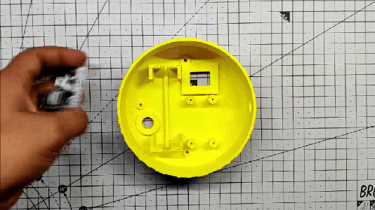

Step 12: Base Assembly

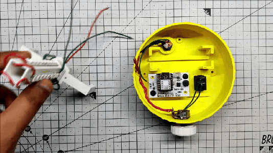

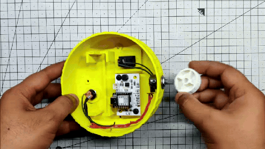

  • The power board, M2 screws, rocker switch, DC barrel jack, and potentiometer are among the components that must be assembled before the base can be put together.
  • The rocker switch, DC barrel jack, and potentiometer are added once the Power board circuit has been installed in its proper location.
  • The potentiometer's 3D-printed knob is then attached.

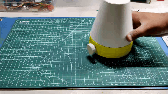

Step 13: Putting Things Together

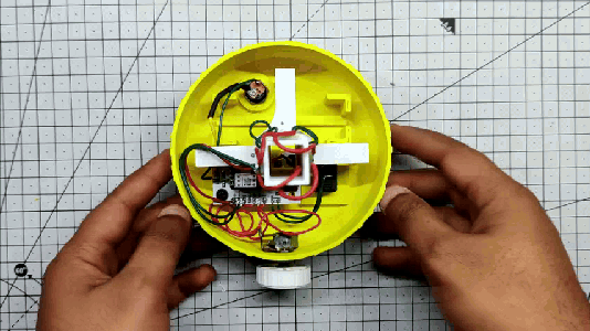

  • To begin the final assembly, we use three M2 screws to join the LED Holder assembly and lower base assembly.

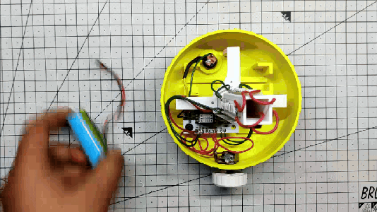

  • We then use the same wiring schematic from earlier to connect everything.
  • Following wiring, we link the Li-ion Cell's wire harness connector to the battery JST connector and slide the Li-ion Cell into position.

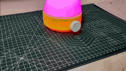

Step 14: RESULT

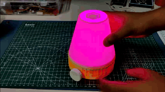

At last, we add the Cone Diffuser in its place, and the CONE LAMP is now ready.
The cone portion serves as a diffuser, absorbing all LED light and dispersing or diffusing it internally to produce a pleasant hue that looks fantastic in low light.
One technique for improving diffusion is to use translucent PLA or print the diffuser portion in transparent resin SLA printers, which will greatly improve the radiance.
By turning the Potentiometer Knob, the hue of blue is controlled, creating different shades of purple.
We may slightly modify the code and upload a code that will randomly change the color of the LEDs as the knob is rotated, or we can specify whatever color we want and use the potentiometer to control that specific color.
