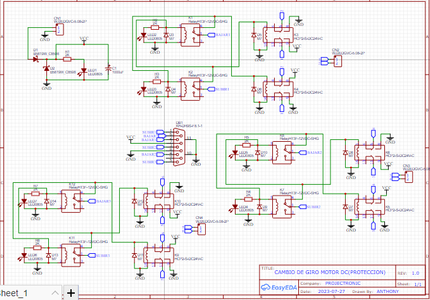

Step 1: SCHEMATIC DIAGRAM
Here we will see the schematic diagram made in the easyeda software with all the electronic components and their respective values.
Step 2: FUNCTIONING
the control element is the relay. It is much simpler, supports a much higher current motor, has less voltage drop, and the motor can use another voltage source (ie, it is theoretically isolated). The problem is that relays have a limited useful life, high frequency PWM cannot be used, and the relay coil adds considerable consumption in the case of driving low current motors.

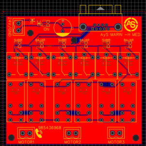

  • 1 PCB
Step 5: CHARACTERISTICS
  • VIN 24VDC
  • I MAX 10A
  • CONTROL OF 3 MOTORS
  • HOURLY AND COUNTERCLOCKWISE CONTROL
  • PROTECTION SYSTEM AGAINST SUCK TURN INVERSION

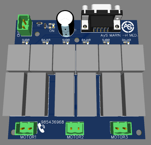

Step 6: EASYEDA
This project was made in the Easyeda software as we can see the tracks and the 3D image of the project working perfectly are no difficulty
