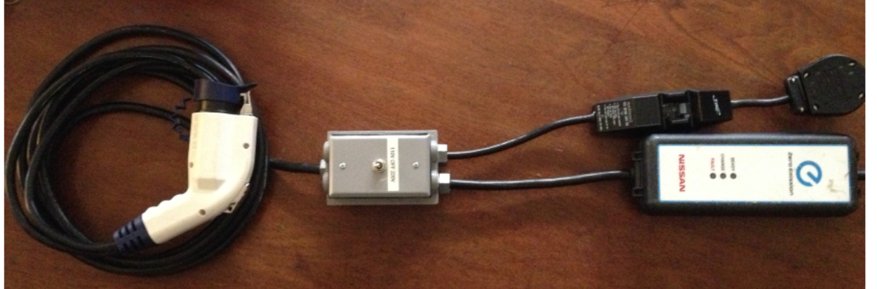

Introduction: (3.0)CONVERTING a LEAF LEVEL 1 (12AMP) CHARGER TO a LEVEL 2 (12AMP) CHARGER
My intent with this design is to make a small, simple, portable level 2 charger out of a level 1 charger that can still function as a level 1 charger. I also want it to be fully automated using the EVSE as the control unit, relays, and a GFCI.

Step 5: DISCONNECT GROUND
Remove ground wire screw and ground wire from the AC wire inside the casing. Leave the ground wire that goes out to the J1772 in place.
Step 6: DISCONNECT 110V
Remove the AC 110V screw and wire from the AC wiring block.
Step 7: PULL THE CORD
Remove the black foam tape from the choke coil (It peels apart with a little work), then remove the choke coil and keep it. I used a small knife blade to pry the latches open (do not force it, it only takes a little push). Next, remove the screws holding the 110V AC in cord in place and pull cord out.
Step 8: STRIPPING THE WIRE
Measure out the length of wire that needs to have its outer layer of insulation removed. Wrap a piece of tape around it as a stop. Use a box cutter to cut back about 1 inch of the insulation. Since you are going to cut off about 7 inches of the red and the black wire, make that cut over them. That way if one of them gets nicked it is the part that is getting cut off anyway. After that first little cut, grab onto the wires and pull them against the slit you started - a little like peeling a banana. This way the insulation on the individual wires does not get nicked.
Step 9: PUTTING IN THE NEW WIRES
Run the 12/4 cluster of wires back thru the grommet in the side of the case. It will be tight so I recommend using a little wire pulling lube, but a drop of liquid soap will work too. Use the securing plate and screws to lock it into place.
For crimping use a ratcheting crimper.
To strip a multi strand wire use a stripping tool one gage larger than the wire. For example 12AWG multi strand wire strips with a 10AWG striper. The number on a stripping tool is for solid wire, multi strand wire is one gage larger.
If some of the strands are cut off when stripping, cut then all off and start over.
Cut the green wire to length, strip the end, attach a crimp connector ring and connect it to ground. There should be 2 wires connected here: the new ground and the ground that runs to the car.
Cut the black wire to length, strip the end, attach a crimp connector ring and connect it to where the 110V black wire used to connect.
Cut the red wire to length, strip the end, attach a crimp connector ring and connect it to where the 110V white wire uses to connect.
Do not plug it in yet.
Step 10: CHOKE COIL
Put the choke coil back on the green wire. Put the foam tape back on the choke coil. The choke coil gets rid of noise and that’s good.
Step 11: DISCONNECTING AND RECONNECTING THE TRANSFORMER
Cut the white wires (first panel) that come out of the circuit board that go to the transformer and strip the tip. Then cut the white wire coming in from the NEMA 14-50 to a matching length (second panel) and strip the tip. Next crimp them together and crimp the open wire. Note the hot black wire coming in feeds the other white wire that goes to the transformer. My preference is for this configuration where the transformer is wired to black and white wires, the standard configuration.
Do not plug it in yet, but we are almost there.
Step 12: OUT WITH THE ONE 110V VARISTOR AND IN WITH THE TWO 110V VARISTORS
This unit comes with a varistor (round thing next to silver bar)(it is taged on step 6) that is designed to protect an 110v circuit and will act like a dead short if connected to a 220V circuit, so IT HAS TO BE REMOVED. My wire clippers are too large to get into that small space and the black rubber stopped me from unsoldering it, so I grabbed it with a pair of needle nose plies and bent it back and forth a couple of times until it snapped off. This is not my preferred approach, but it works.Note: if I were going to try this again I think I would take a pair of small angle wire cutters and grind the site's down so that I could get in that tight space and clip off the wires on the varistor.
Close the case and put the screws back in.
The plug is just a normal NEMA 14-50 plug, so follow the directions that come with it.
I then added two 140V maximum operating voltage varistor (this is what is routinely used for a 110V circuit)(The number on the varistor following the “K” should be 140)to the plug across hot (red) - return (white) and hot (black) - return (white). This protects both the 110V and 220V circuits.
Close the plug and put the screws back in.
Plug it in.
