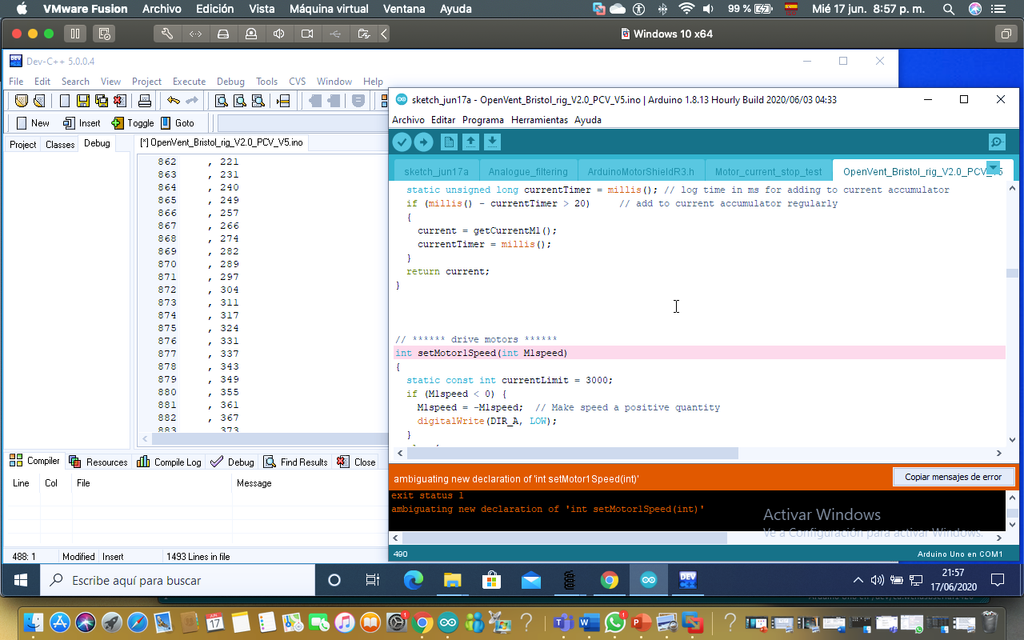

Step 6: Software
Download the latest version of my Arduino code from GitHub using the following link: https://github.com/Open-Vent-Bristol/Open-Vent-Bri...
- Download "Motor_current_stop_test_V3_dwell_control.ino" and "Analogue_filtering.ino"
- Place these 2 files in a folder called "Motor_current_stop_test_V3_dwell_control" in your Arduino sketchbook folder
- Then when you double-click to open "Motor_current_stop_test_V3_dwell_control" it will automatically include the other file in another tab of your IDE
You will also need to install the Arduino motor shield rev3 library: https://github.com/gallingern/arduino-motor-shield...
"Motor_current_stop_test.ino" is an old code, do not use.
Upload the code to the board but before you run it for the first time make sure the "max pressure/tidal volume" POT is dialed all the way down (all the way anti clockwise).
Once you run it for the first time be prepared to stop it quickly because you have a 50/50 chance that the motor is spinning in the right direction. If the motor trys to spin the wrong way initially then swap the motor wires around to reverse the polarity, if that doesn't work then gradually increase the current limit by dialing up the "max pressure" POT because bigger motors could be tripping out of the current limit upon startup. I think the current limit range on the POT is from 800mA to 1.2A.
