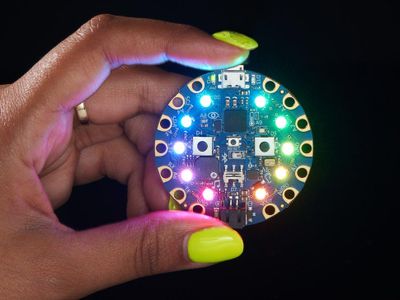

Adafruit Circuit Playground Bluefruit

Step 1: Write a Circuit Python Program!
Write a Circuit Python program that plays music. I used the pwmio library to play through the built in speaker, and used slide potentiometers to control tempo and select songs.
The code works as follows:
A "play" function requires a note as a parameter and a duration as an input from a potentiometer, which ranges from 60-160 bpm.
"Song" functions play notes in a predetermined order, and the melody is repeated within a for-loop of another function. The blues function, for example, plays a blues melody 12 times, and inputs key changes.
The code can be modified to incorporate the ability to shift keys, but I ran out of room on my CPB. Maybe the next time around, an Arduino Nano may be a better choice.
Lastly, the second potentiometer is split into 4 sections: Off, Blues Melody 1, Blues Melody 2, and Metronome. Each section has a designated Neopixel color (Red, Purple, Blue, Green) and changes at the end of every measure due to the "check" functions".
I've attached my code to this step, or you can view it on Github here: https://github.com/scordos/CPB-PWM-Jam-Buddy
