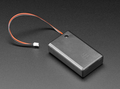

  • battery pack

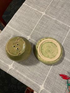

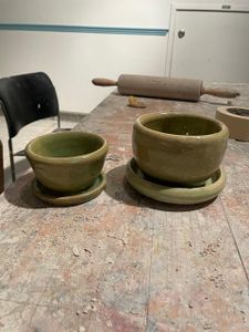

I'm currently taking a ceramics class at Boston College as well, so I decided to learn how to throw a planter pot. I started with a softball sized lump of clay on the wheel, centering it, opening up the center, and bringing up the sides to create a tall bowl shape. I poked three holes into the bottom so it can drain water as well. I also threw a small plate that sits underneath the planter to catch any water drainage. I trimmed the bowl shape to be more refined and trimmed a thin foot onto the bottom of the plate after the clay had partially dried. I glazed both in a glaze called "Nelson Red" which is actually a light yellow-green. This process took a few weeks to complete, as it had to go through both a bisque fire and glaze fire to finish.

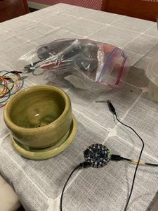

Step 2: Gather Electronics and Assemble

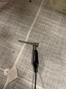

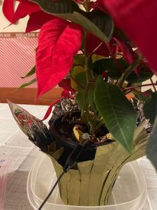

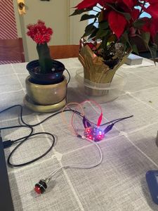

This project was relatively simple in terms of electronic parts because the CPB has so many sensors built into it already. I used an alligator clip to one of the capacitive touch pads and connected it to a nail that is conductive to measure moisture in the soil. I used another two pin to alligator clips to connect an extra button to the CPB, but this could have easily just used two alligator clips as well. I connected the button to GND and one of the capacitive touch pads that are also digital input/output. The light sensor and accelerometer are both built into the CPB already.

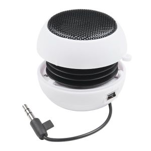

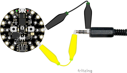

I attached a speaker to the CPB to emit these sounds - this is optional if you do not want sounds on your plant monitor.

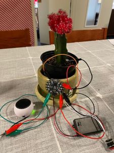

Step 5: Test and Complete
At this stage, you should have a working plant monitor! It took me a few tries to calibrate the ranges for light and moisture how I wanted them, be sure to test these. I attached a battery pack so that the monitor can run independently. I also attached the CPB to the side of my planter using wall putty. Have fun monitoring your plant!
