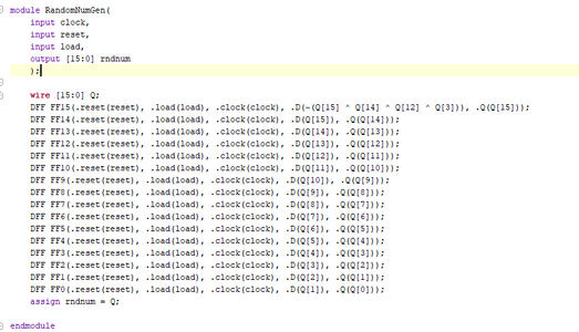

Step 2: Random Number Generator
We used D Flip Flops to create a random number generator. To do so, we used 16 flip flops, with three bits XOR'd together to create the random number. This number will be represented by LED lights on the Basys3 board.

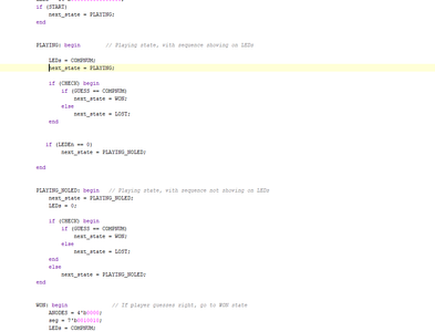

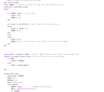

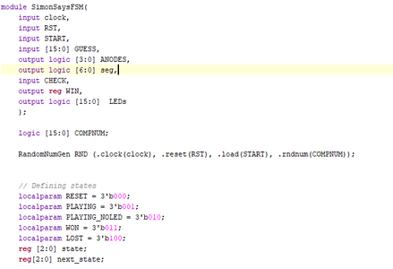

Step 3: Game FSM
Here is the code for our top level module code.

This game is a Simon-says type game. Pressing the top button will generate a random series of LEDs to flash for about 2 seconds. After they disappear, the player will attempt to flip on the switches that remember being lit up. After the player flips the switches, they press the bottom button to check their answer. If it is correct, the seven-segment display will display an “S” for success, or “L” for loss, depending on if the player guessed correctly. If the player wants a new attempt at the game, they must press the center button for it to restart.
