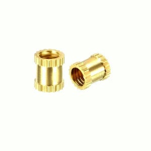

Marks all holes of Power Supply and Mainboard on the inside of CPU case. Here I am using the Brass Female nut to attach the mainboard and throw hole screw nut bolt the power supply attaching. Also noted that here I am using another power supply for other components.
Note: Refer image for more understanding.
Tip: Use solder wire and solder Iron to joint Brass Nut on metal plate of CPU.

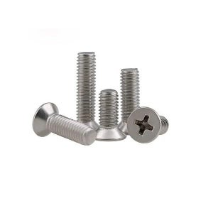

Use Allen Bolt( Bolt Head Cap) (5x60mm-4) and its nuts to attach the Base with CPU Bottom.
