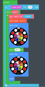

    Next, I used a forever block and an if statement. In the if statement, if the sound level was above 150, I used a while loop to check if the alarm was activated by checking if play was true. While the alarm was activated, the alarm system would go off, so a siren sound would play, and a ring of alternately lit up red LEDs would flash with a gap of 2 seconds between each flash. In the while loop, the run variable was also set to true to indicate that the alarm was going off. (img 2)

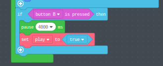

    Lastly, I had one more if statement within the forever loop that checked if button B was pressed. If it was triggered, the alarm would be reactivated, so after a pause of 4 seconds, the play variable would be set to true. (img 4)
