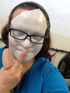

Step 8: Mask
I spent quite a while making a large, thin pancake of plastic for a stand for our mascot Sparkles, but when it reached the size of my face, that plan went right out the window. Keep an eye out for a full tutorial on making an InstaMorph mask in the next couple days. Until then, enjoy the pictures.
