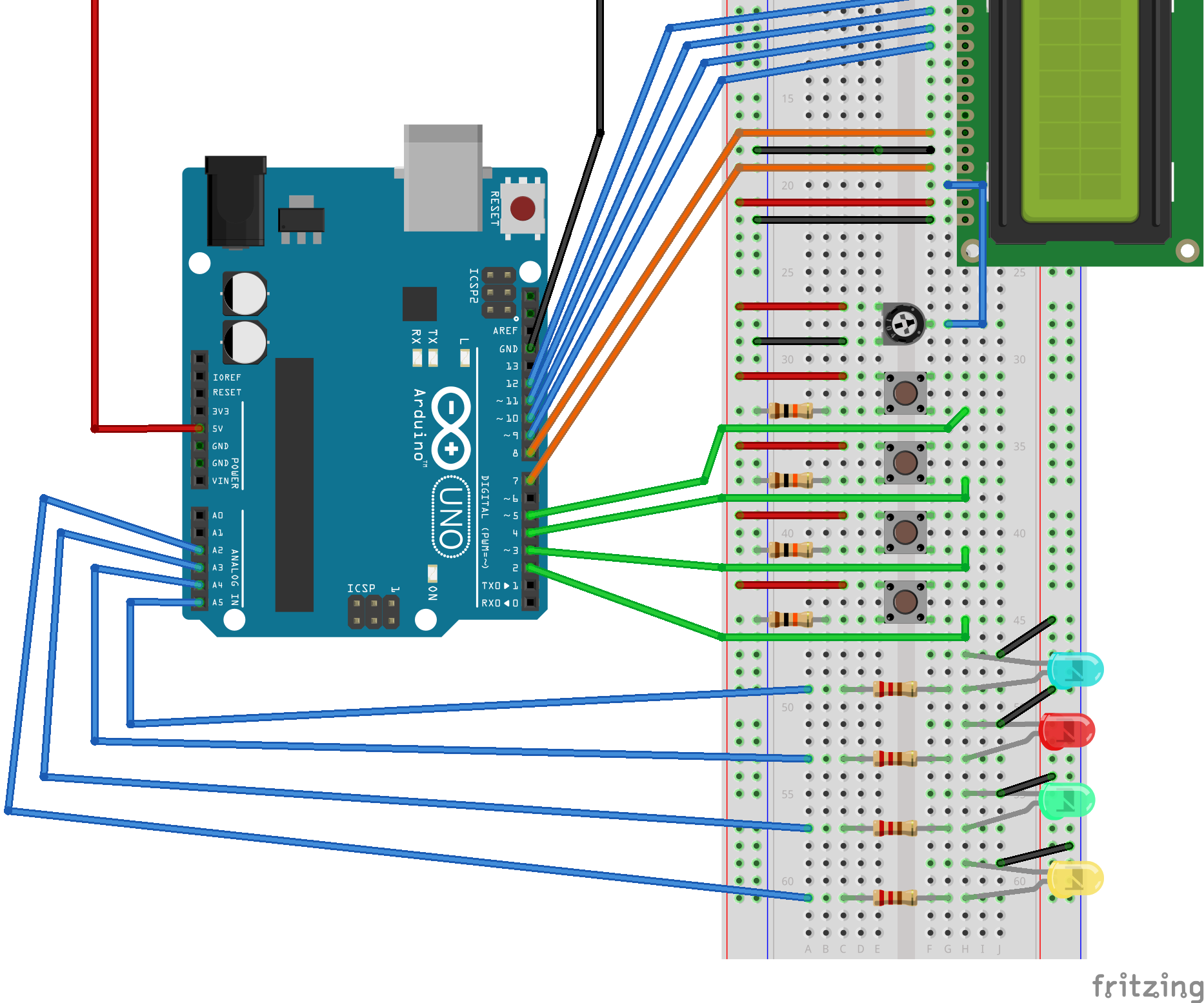

Step 1: Connecting the 4x4 Keypad
To connect the 4x4 keypad, connect each pin on the keypad with a pin on the ardunio using a jumper wire. The pins used in the diagram are pins 4-11.
Step 2: Connect the Servo Motor
The servo motor requires 3 connections to the Arduino board:
1. Connect the ground wire to the GND port on the Arduino
2. Connect the power wire to the 5V port on the Arduino
3. Connect the output wire to one of the available ports on the Arduino, port 3 was chosen in the diagram
