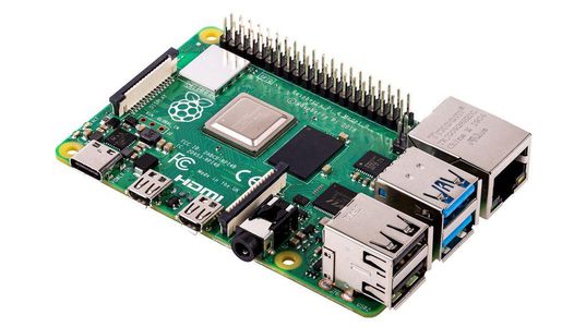

- Raspberry Pi Camera v2/v3
- Raspberry Pi

- Connect second module to Raspberry Pi
