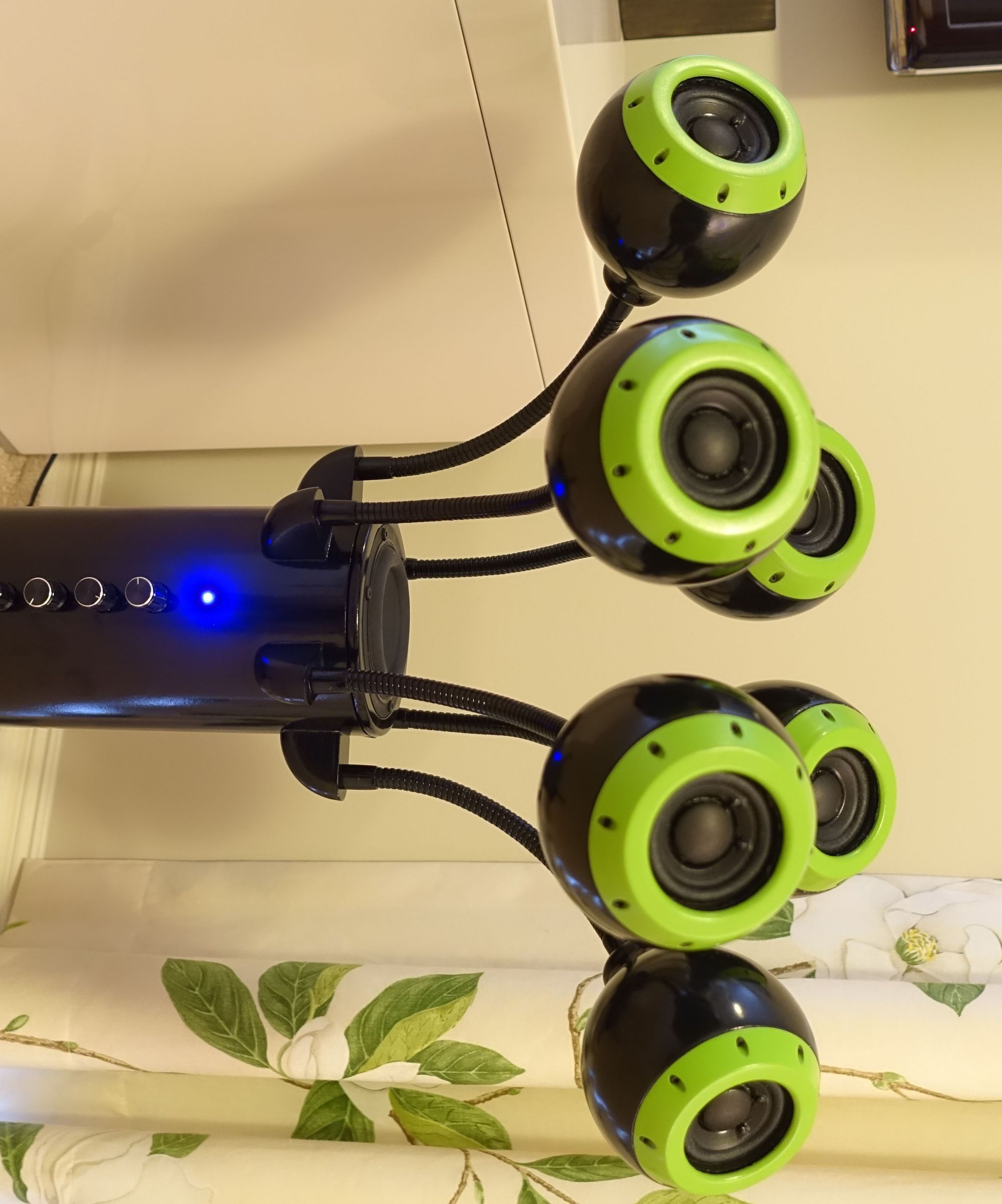

I've made a few Bluetooth speakers recently (links below) and whilst they are great to look at and fantastic to listen to but the "Name" that comes up on my phone (or Bluetooth streaming device) is either:
1) Something boring like "CSR 8645"!
and/or
2) The same as another speaker (if I've used the same module)
I've discovered a way to reprogram this "Friendly Name" It's pretty straight forwards but there are a few steps...

Links to my BT speaker projects:
https://www.instructables.com/id/Hydra-a-MONSTER-Bluetooth-Speaker/
https://www.instructables.com/id/Meet-Holman-the-Ultimate-Bluetooth-Speaker/
