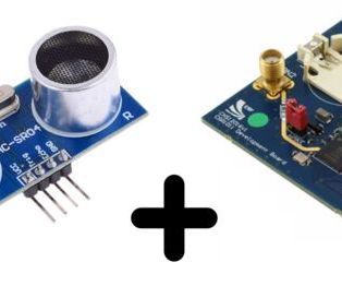

Introduction: CSR1011 - Using Infrared Sensor
The CSR1011 is a single mode Bluetooth Smart chip and this tutorial show how to access its GPIOs and read a infrared sensor state, to detect the presence of a object.
Step 1: Infrared Sensor
The infrared sensor has a transmitter and receiver circuit, positioned side by side. When an object or person passes in front of the sensor, the IR signal is reflected and detected by the receiver, which puts the output pin low (LOW), and triggers a led on the back of the sensor.
Step 2: Hardware Scheme
To connect the infrared sensor in the CSR1011 was designed a hardware to power it, because the CSR1011 is powered with 3v3 and the component needs 5v to work. On CSR the pin 31 (GPIO 31) was used to connect the infrared sensor.
