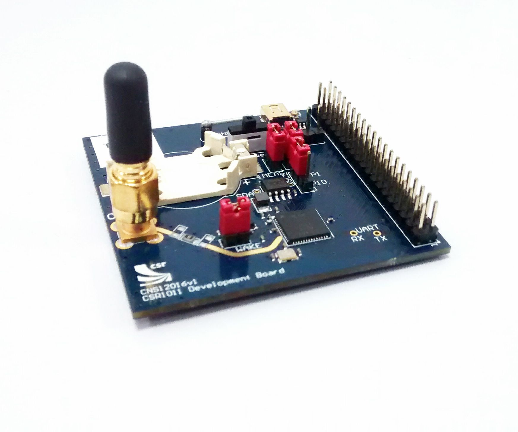

Introduction: CSR1011 - Using Ultrasonic Sensor
The CSR1011 is a single mode Bluetooth Smart chip and this tutorial show how to access its GPIOs and read the values of a ultrasonic sensor.

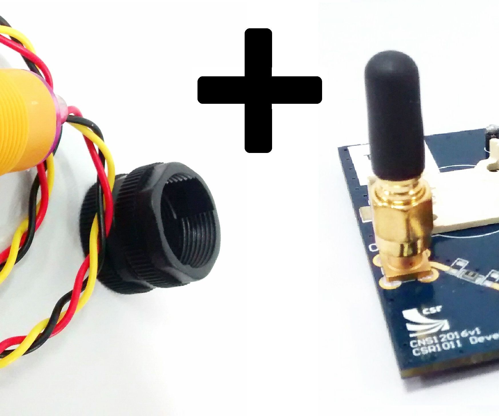

Step 1: Ultrasonic Sensor
The ultrasonic sensor used was the HC-SR04. To begin the measurement it is necessary to power the module and place the Trigger pin at high level for more than 10us. Thus the sensor will emit a sound wave that when finding an obstacle will rebound back towards the module, being that at this time of emission and reception of the signal the ECHO pin will be at high level. Thus the distance calculation can be done according to the time when the ECHO pin remained high after the Trigger pin has been placed high.
Step 2: Hardware Scheme
To connect the ultrasonic sensor in the CSR1011 was designed a hardware to power it, because the CSR1011 is powered with 3v3 and the component needs 5v to work. On CSR the pin 15 (GPIO 18) was used to connect the Trigger of the sensor and the pin 17 (GPIO 19) was used to connect the Echo of the sensor.
