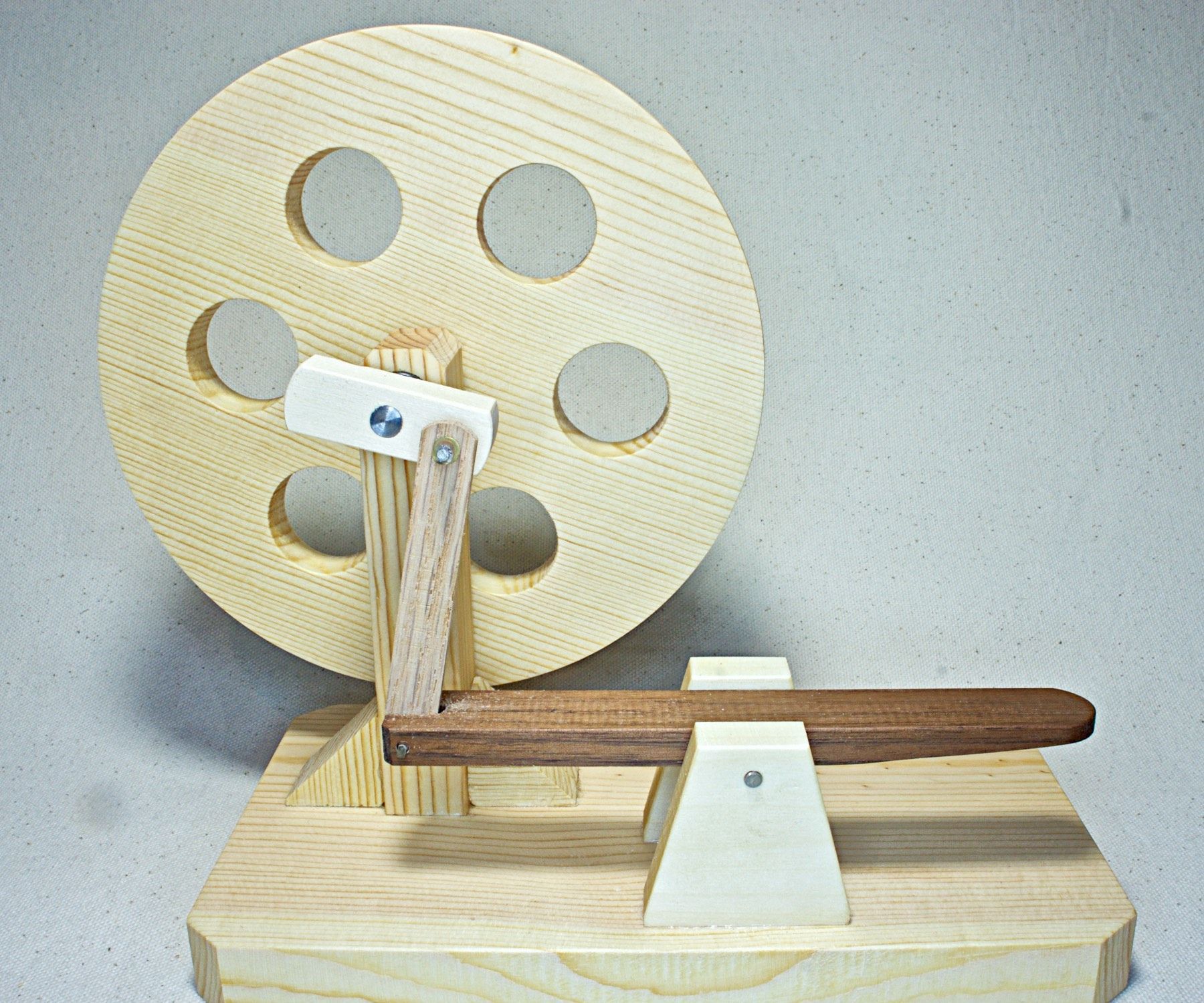

Step 5: Solar Whirligig
An amusing application of any solar engine is to operate a "Solar Whirligig" as pictured here. This video shows it in action.

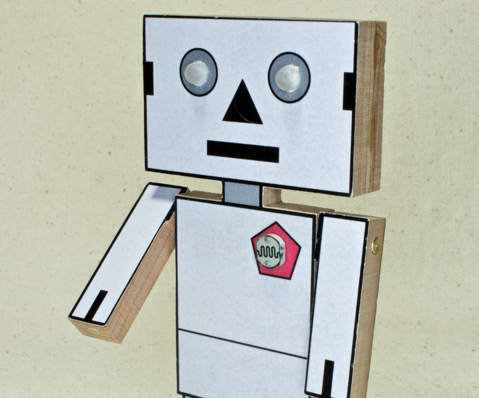

Step 6: Walker the Robot
This is "Walker" - a little robot that soaks up solar energy and every now and then takes off for a short but energetic stroll. His energy comes from a RU6730 polycrystalline cell atop his head. You can catch a glimpse of him in action on this short video.
