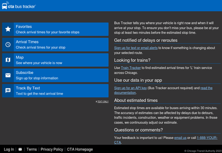

Step 1: CTA API

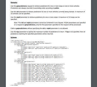

First thing you want is access to the CTA API
Go to the cta bus tracker website and create an account
Then on the main page click on Sign up for API key and follow the on screen instructions
Once you have your specific API key sent to you save it as it will be used to accesses the API data
To get a useful link look at the API documentation
There are many things you can track and it explains how to set up the link
The link I used is https://ctabustracker.com/bustime/api/v2/getpredictions?key=XwijuXRX2qnUuBfptxUk3t5K&rt=94&stpid=4273&top=1&format=json
Base URL for this project:
https://ctabustracker.com/bustime/api/v2/getpredictions?key=(your own key)&rt=(the number of the bus route)&stpid=(the individual number that identifies your stop)&top=1&format=json

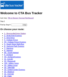

To find your route ( rt ) and stop # ( stpid ) go into this URL and you will use the key got earlier in your URL as ( key )

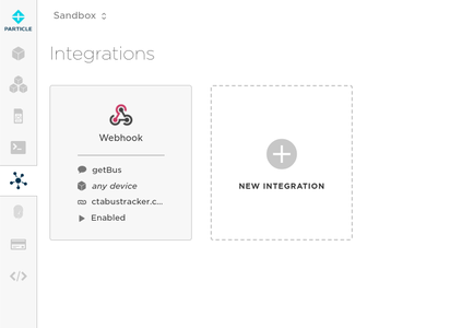

Step 2: Create Webhook

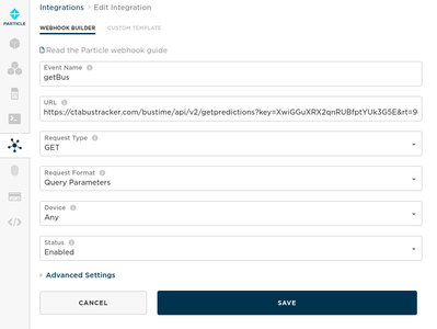

We need to create a webhook that will call the URL we made and get us the bus data every minute
Go to console - then integrations - then create a new webhook
Click webhook and type in the following in the appropriate boxes as shown in the picture
You can name it anything you want but you want to replace the URL with your own URL that we made in step 1

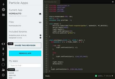

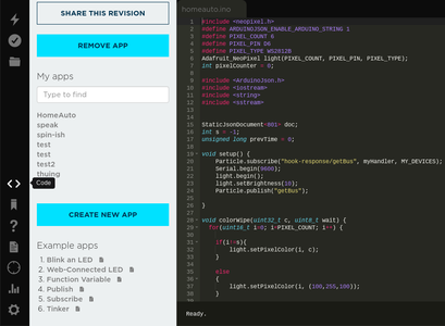

Step 3: Code
Copy this code by opening "code" and making a new app
#include <neopixel.h>
#define ARDUINOJSON_ENABLE_ARDUINO_STRING 1
#define PIXEL_COUNT 6
#define PIXEL_PIN D6
#define PIXEL_TYPE WS2812B
Adafruit_NeoPixel light(PIXEL_COUNT, PIXEL_PIN, PIXEL_TYPE);
int pixelCounter = 0;
#include <ArduinoJson.h>
#include <iostream>
#include <string>
#include <sstream>
StaticJsonDocument<801> doc;
int s = -1;
unsigned long prevTime = 0;
void setup() {
    Particle.subscribe("hook-response/getBus", myHandler, MY_DEVICES);
    Serial.begin(9600);
    light.begin();
    light.setBrightness(10);
    Particle.publish("getBus");
void colorWipe(uint32_t c, uint8_t wait) {
  for(uint16_t i=0; i<PIXEL_COUNT; i++) {
    if(i!=s){
        light.setPixelColor(i, c);
    else
        light.setPixelColor(i, (100,255,100));
    light.show();
    delay(wait);
  light.setPixelColor(0, (100,100,255));
void loop() {
    unsigned long currTime = millis();
if ( currTime - prevTime >= 60000 )
prevTime = currTime;
        if(Time.hour() = 11)
void myHandler(const char *event, const char *data)
    const char* json = data;
    deserializeJson(doc, json);
    String prdtm = doc["bustime-response"]["prd"][0]["prdctdn"];
    int in = prdtm.toInt();

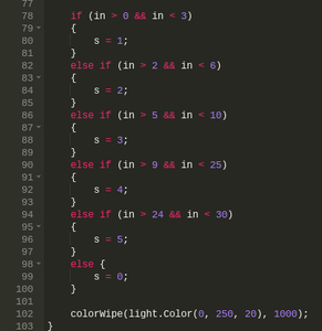

    if (in > 0 && in < 3)
        s = 1;
    else if (in > 2 && in < 6)
        s = 2;
    else if (in > 5 && in < 10)
        s = 3;
    else if (in > 9 && in < 25)
        s = 4;
    else if (in > 24 && in < 30)
        s = 5;
    else {
        s = 0;
    colorWipe(light.Color(0, 250, 20), 1000);
The second picture shows the main customization part where you can change which light changes depending on how many minutes away the bus is
And color wipe is a quick way to change the main light colors
