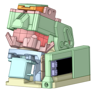

The dimensions are ca 7cm x 9cm x 9cm (WxDxH).

  • 10 parts to be 3D printed
  • 2 small servos

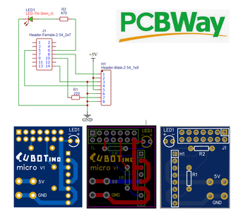

  • PCBWay that has voluntarily sponsored the board for this project: This means I got triggered to learn how to draw the board (cool) and you can benefit from ordering the PCB instead of doing it yourself.

Step 4: Make the Connections_Board & Wiring
The connections board connects the servos and the Top_cover led to the Raspberry Pi.
PCBWay has sponsored the board for this project:
Despite the board is rather simple, I got the trigger to learn how to design a (simple) board.
The designed board also includes a led, to make the Raspberry Pi ACT led visible.
The tests of the first samples went ok.
Gerber files are available at the GitHub repository.
Info on how to order the PCB are in the embedded Connections_board_yyyymmdd.pdf file
Anyhow, the board is very simple and it can also be made with a perfboard (one or two sides).
Additional info at "How_to_make_ .... .pdf" document, embedded in Step 2 of this Instructables.

There are a total of 10 parts to be 3D printed, for about 130 grams (when PETG is used).
All parts have been designed to be printed:
  • without supporting the overhangs
  • on printers with at least 100x100mm printing plate LoL
The stl files are stored at GitHub: https://github.com/AndreaFavero71/CUBOTino_micro/tree/main/stl
In case you'd like to modify your parts, the step files are also provided, at GitHub: https://github.com/AndreaFavero71/CUBOTino_micro/tree/main/stp
